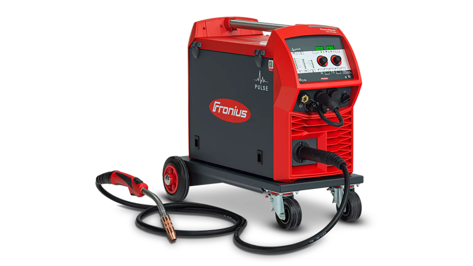

TransSteel Compact
No matter what the welding task - MIG/MAG, TIG and electrode welding with just one device.
Whether a construction site or a workshop, from agricultural enterprises to metalworking companies – for assembly, repair, and maintenance work, the TransSteel Multiprocess series masters the MIG/MAG, TIG, and electrode welding processes to professional levels.
