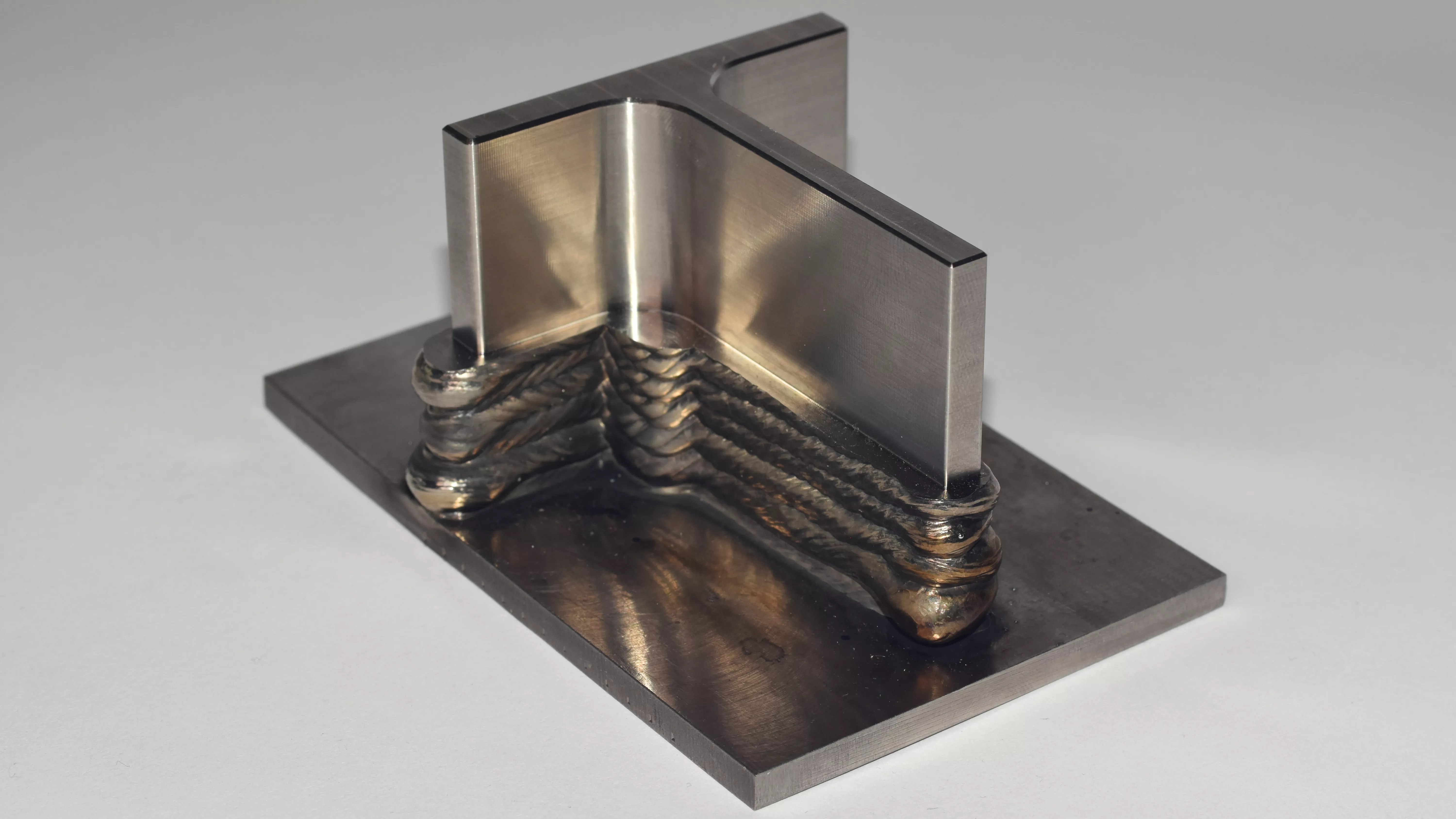

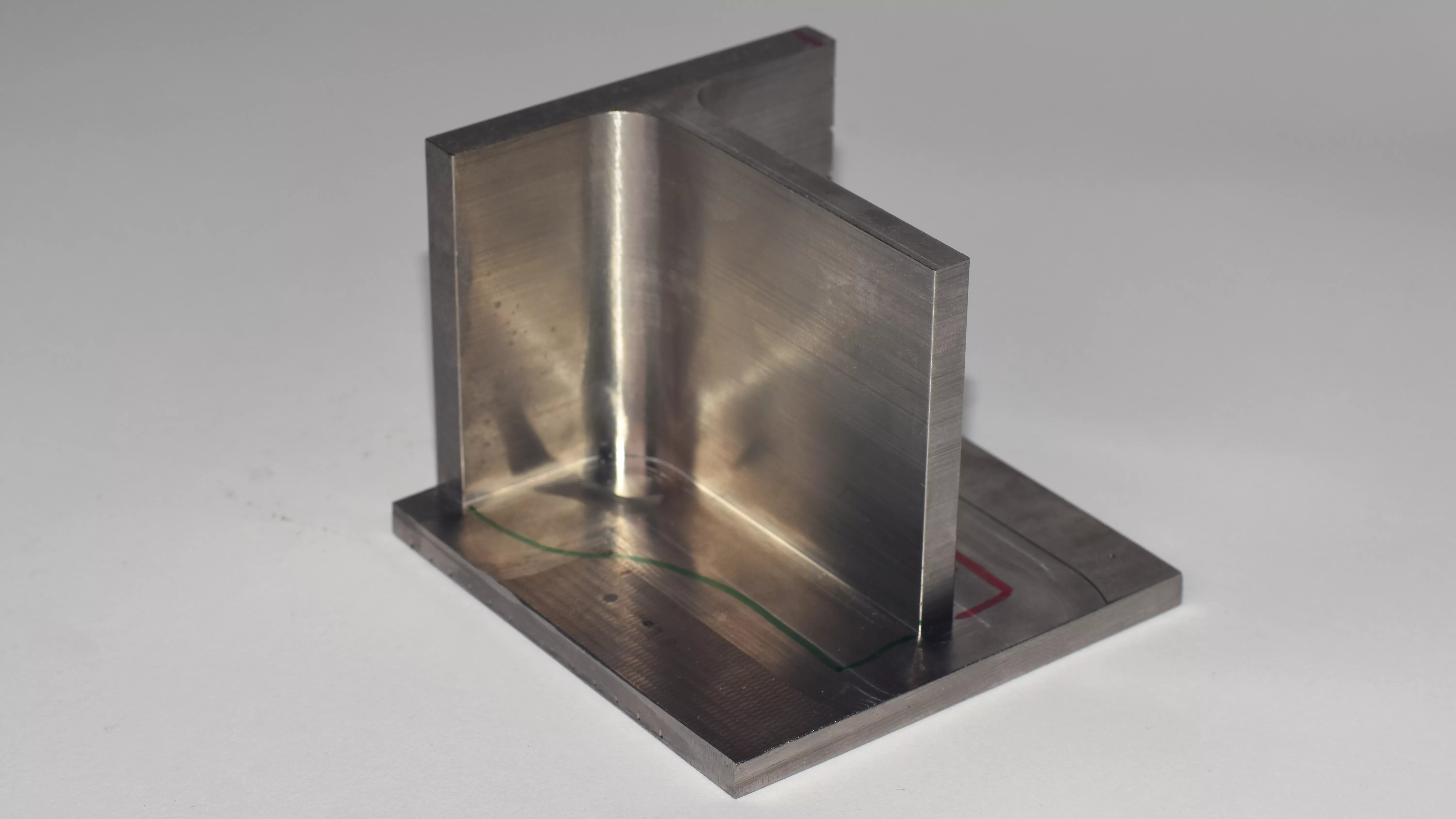

Wire Arc Additive Manufacturing is arousing a great deal of interest in several industries. Arc-based manufacturing by building up layers allows for a high degree of flexibility in component geometry. For prototypes and small-batch production runs in particular, it is a more cost-effective solution than other additive processes for metal. The key factor in determining the quality of components produced is the welding process. Cold Metal Transfer from Fronius effectively fulfills all the conditions for Wire Arc Additive Manufacturing.
Additive production methods generate components by building up material layer by layer. The most well-known example of an additive method is 3D printing. Wire Arc Additive Manufacturing, which is based on the arc welding process, also produces metal parts layer by layer, with the layers formed by the melting wire electrode. This generative method is particularly advantageous when complex component geometries have to be produced, as the design options are virtually limitless. In addition, parts can be manufactured at low cost and extremely quickly – which makes Wire Arc Additive Manufacturing a very attractive option for prototype construction and/or small production batches. Processing time, tool wear, and material loss during machining – especially with the conventional approach of milling out the workpiece from a solid block – all mean significant extra costs.
What is Wire Arc Additive Manufacturing?
There are a number of generative production methods for metal. Essentially these can be divided into two fundamental types: powder-based processes and wire-based processes. In powder-based processes, the layers are built up using molten metal powder. The most common method, the powder bed process, produces extremely precise results, but is somewhat slow in production. Wire-based processes, on the other hand, build up the component by melting a wire-shaped filler metal, requiring the use of a laser, electron beam, or arc. These processes have a high deposition rate and therefore help to cut production times.
Wire Arc Additive Manufacturing is a wire-based process, and uses the gas metal arc welding process (GMAW). Wire Arc Additive Manufacturing itself offers a number of advantages besides its high deposition rate (up to four kilograms per hour with steel materials). In the future, multi-wire solutions could give rise to even higher deposition rates. Equipment and material costs are also important criteria, which is another strength of Wire Arc Additive Manufacturing: all you need is a suitable welding system. There is no requirement for costly special equipment, such as the vacuum chambers needed for the faster electron beam process.

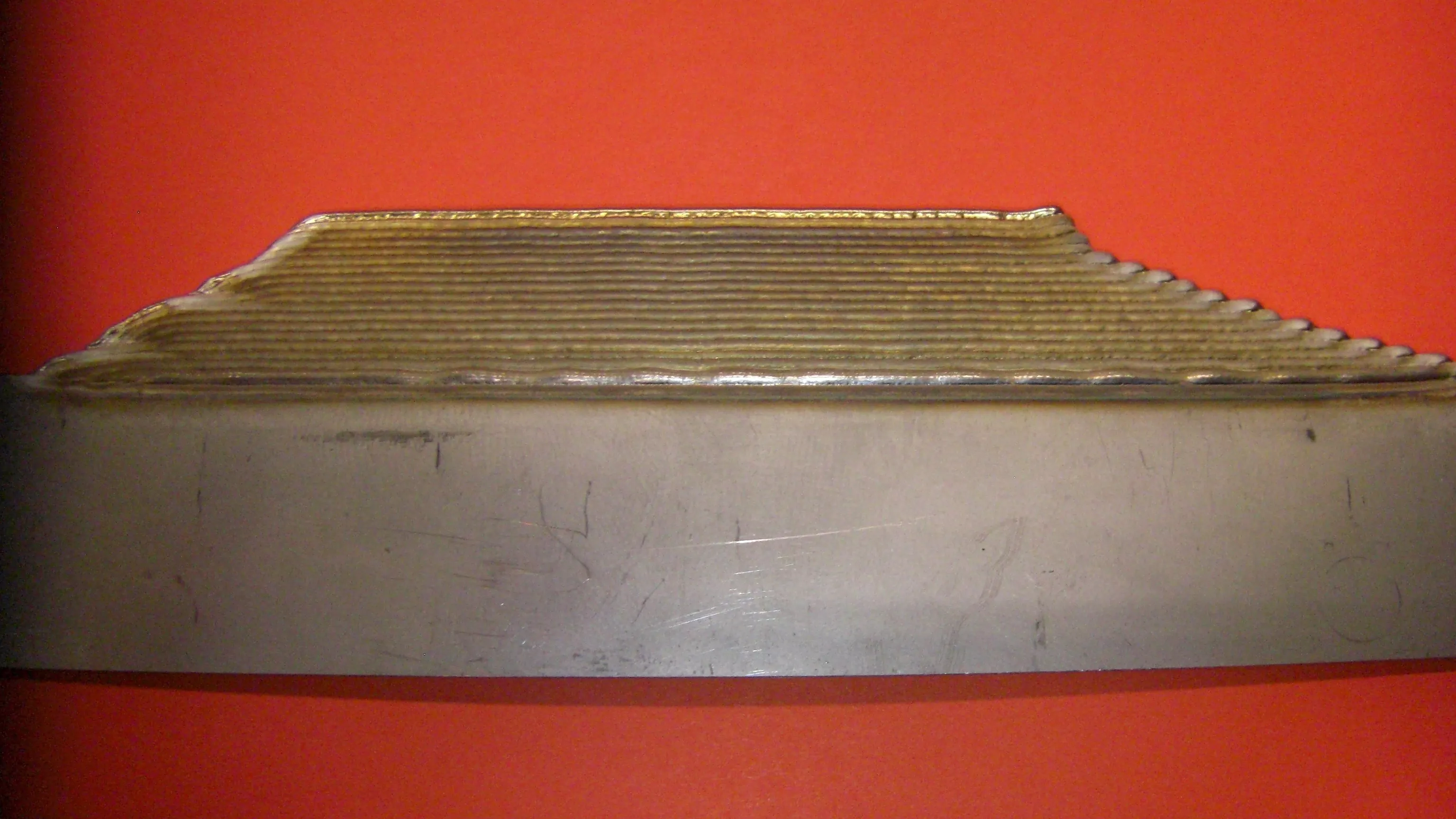

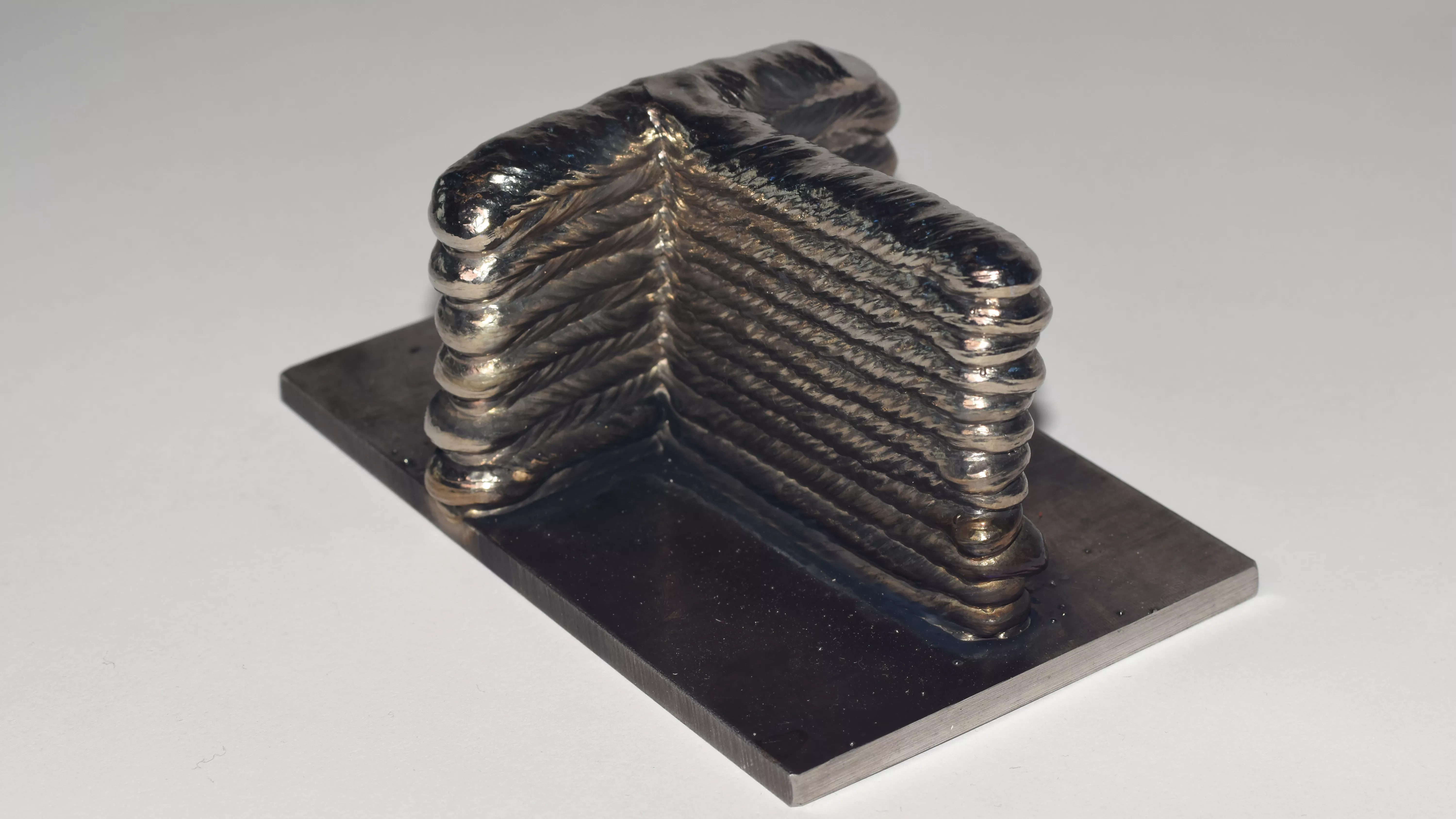

A stable welding process and effective heat dissipation are essential for large-scale 3D metal printing. The welding process needs to be sufficiently low energy such that when a new layer is applied, the existing layers do not melt again. In other words, the process needs to be as "cold" as possible. Furthermore, the weld layers need to be continuous, spatter-free, and consistent. If any flaws were to occur, these would be replicated in each subsequent layer.

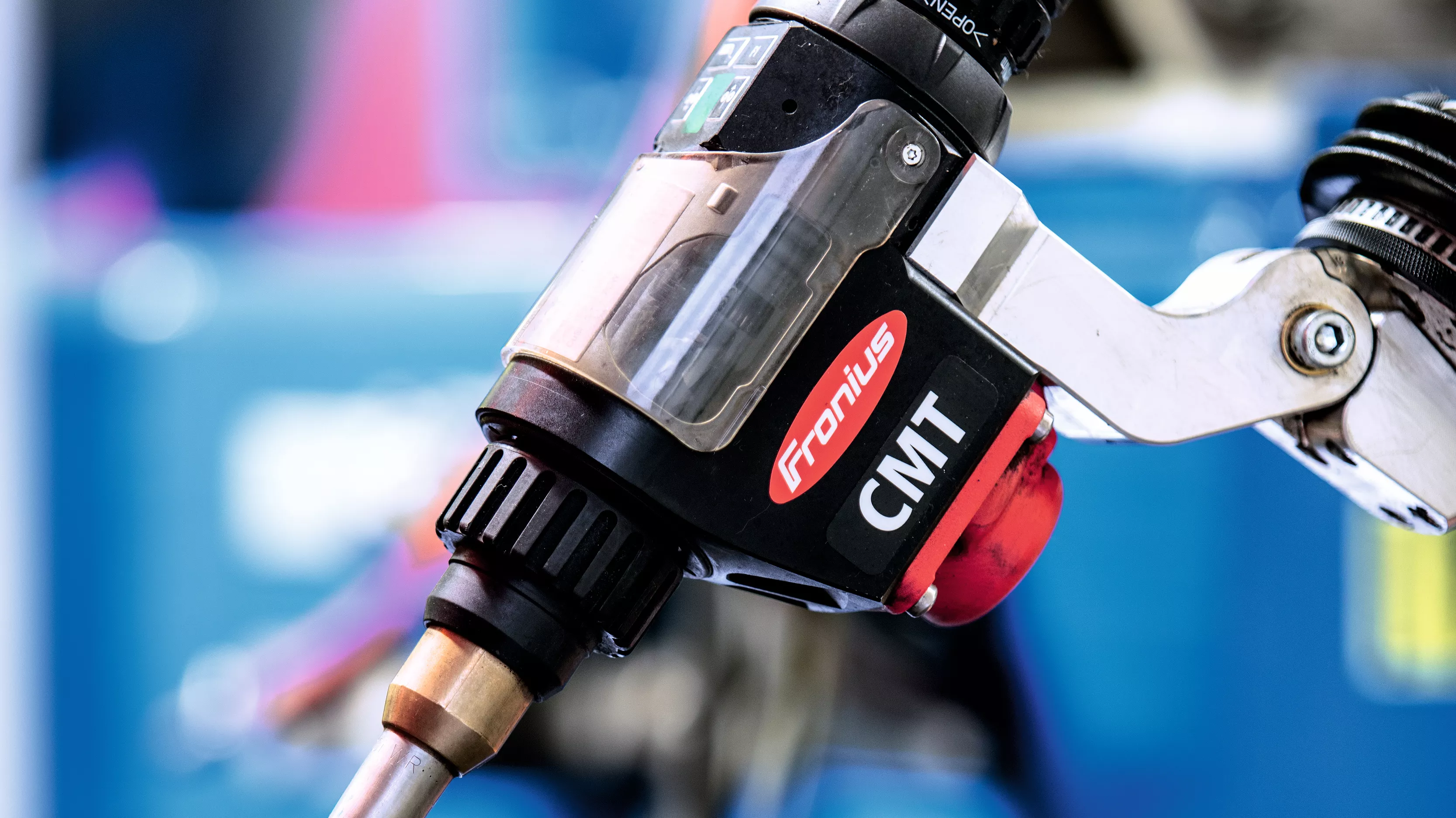

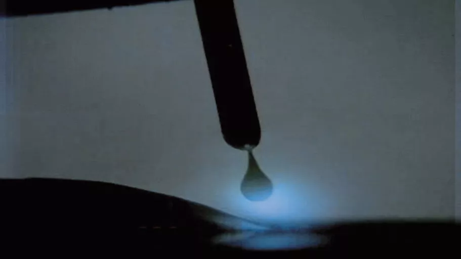

The CMT GMAW process from Fronius and its process control variants meet these requirements. They produce a stable arc and a controlled short circuit with long short circuit times. This means that the heat input is lower and the material transfer is practically spatter-free, which helps to prevent flaws.
Two process control variants of CMT are particularly well suited to Wire Arc Additive Manufacturing. One is the CMT additive process characteristic, which has been optimized for large-scale 3D metal printing. It achieves high deposition rates while transferring very little heat into the component. The CMT Cycle Step variant reduces the arc power even further through the controlled deactivation of the arc during the process phase. However, this particularly "cold" process does need longer to build up the layers, as the deposition rate is lower.
