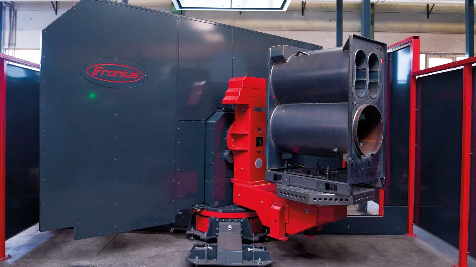

Increasing skills shortages and continued growth mean that many companies, including Heizomat, require automated solutions. Today, the company uses three Fronius robotic welding cells to weld boilers. The cells are equipped with the Pathfinder offline programming and simulation software.
“Without automation, we would have to take on more qualified welders, but they’re few and far between on the labor market. That’s why we decided to use robotic systems,” Vorbrugg continues. “Fronius quickly reassured us. From the outset, the focus was on the welding challenge. The kinematics were designed on the basis of their solution and not the other way around. Today, we have three robotic welding cells with reversible positioners that do exactly what we want: reliably weld perfect seams.”
For the construction of the wood chip heaters, standard components (boilers) made of 6 mm hot-rolled, unalloyed S235JR structural steel and each weighing 700–950 kg are joined in a gas- and water-tight manner. Depending on the requirements, the number of individual components varies between 300 and 700.
Christoph Stieglitz, welding expert, has no doubts: “The Pulse Multi Control (PMC) process is perfect for welding steel boilers. In comparison to manual welding, we achieve significantly higher speeds of up to 80 cm/min with optimal root penetration. The seams are visually perfect and of a consistently high quality.”
PMC is a modified pulsed arc process that is characterized by a powerful, stable arc and finely controlled low-spatter droplet detachment that delivers a high deposition rate. Even components with tight tolerances and significant variations in wall thickness can be flawlessly welded using PMC. Arc length and penetration stabilizers ensure precise control and high process stability with less energy per unit length.
“Automated welding has clear advantages for us,” explains Vorbrugg. “Firstly, we can set up the systems in parallel, which avoids non-productive downtimes. Secondly, we weld much faster than by hand. Instead of 6 hours, the robot only needs 1 hour 40 minutes for each boiler. And thirdly, using the Pathfinder offline programming and simulation software means we spend significantly less time teaching the welding robot.”

“Our system consistently welds down the center of the weld,” explains Stieglitz. “This is achieved using an automatic weld search feature, which works as follows. The robot moves the welding wire up to the component, remembers the point, and stores its coordinates. As soon as all required points on the X, Y, and Z coordinates have been measured and recorded, they are compared with the virtual component and, if there are any deviations, the welding path is corrected accordingly.”
The exact position of the welds is a basic requirement if gas- and water-tight boilers are to be produced to the expected high levels of Heizomat quality. Each boiler is therefore subjected to a 24-hour leak test at 9–11 bar water pressure before it is installed in one of the world’s most sought-after wood chip heating systems. Visually flawless seams are equally important, especially in the USA, as the ASME standard demands 100% perfect welds even in the hidden parts of the boilers.
