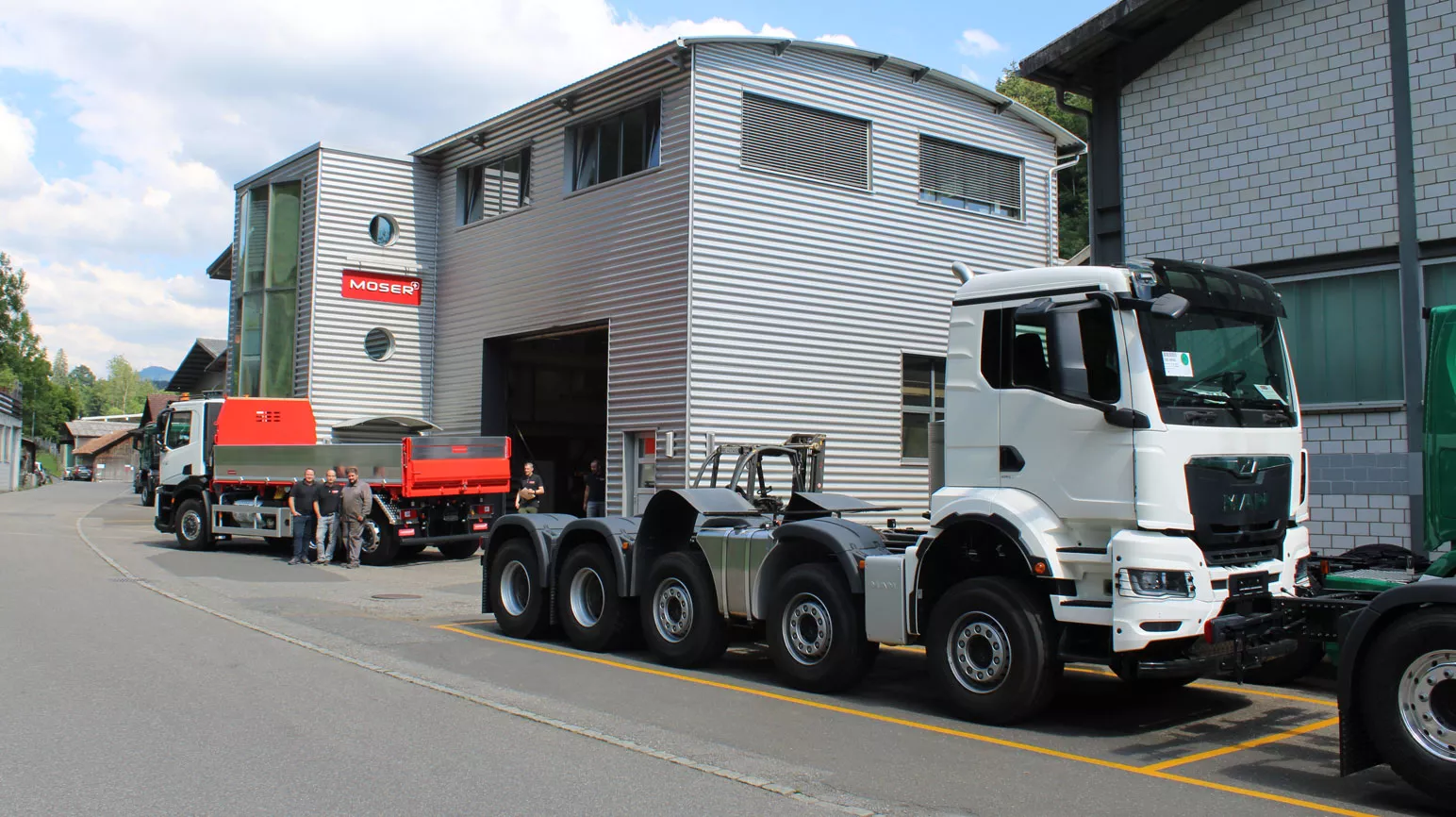

Manufacturing halls of Moser AG Kipper- und Fahrzeugbau in Steffisburg, Canton of Bern, Switzerland.
