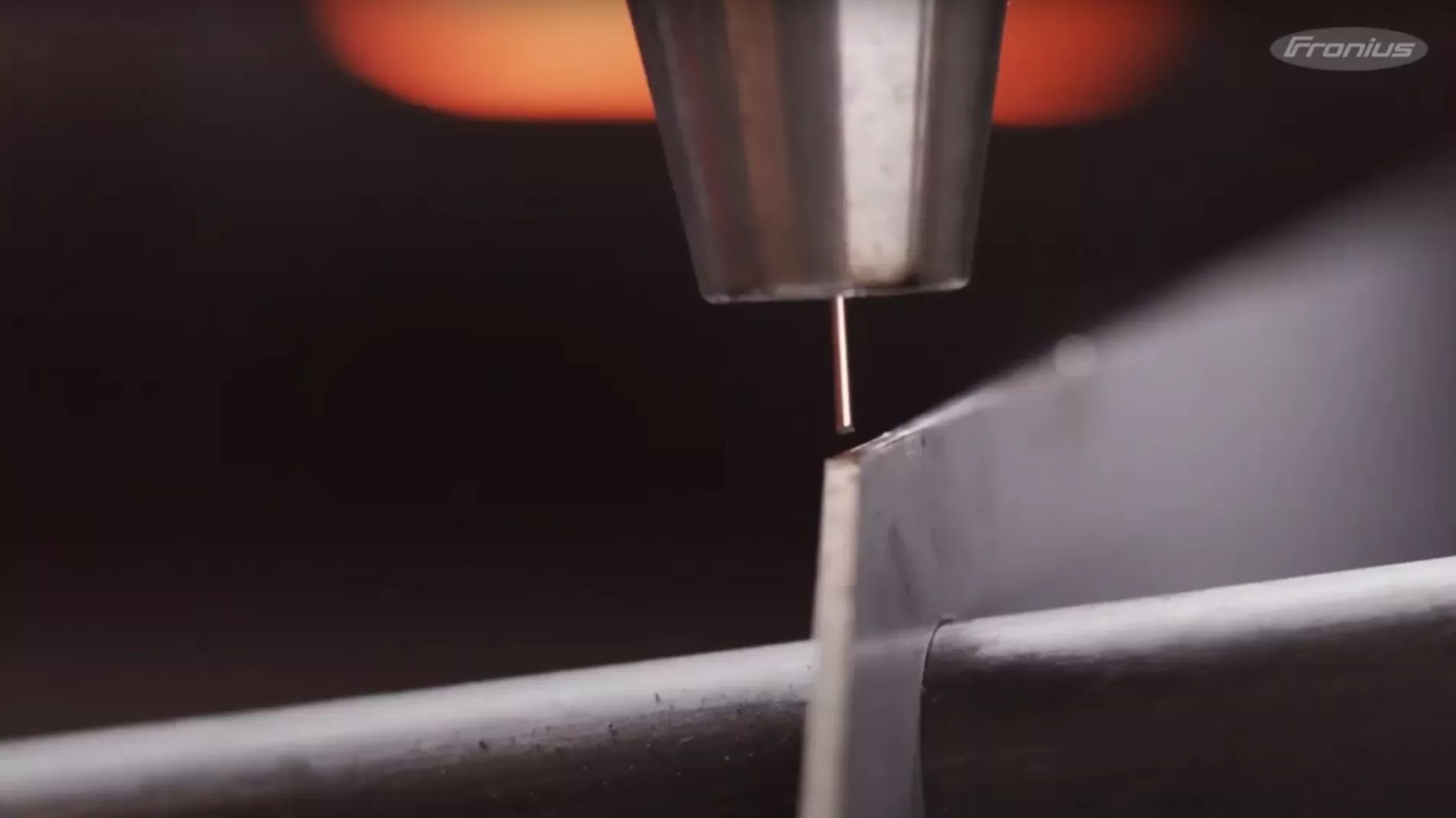

Detect edge positions and air gap heights with WireSense
The patented WireSense technology works together with the welding system to enable the robot to detect the edge position and any air gaps between the sheets. To do so, the wire electrode becomes a height sensor. During the WireSense scanning process, the robot first makes its way to the required position. The welding wire, to which a low sensor voltage is supplied, scans the component with reversing wire movements in the range of one hundred Hertz. If the wire touches the component, it results in an imperceptible short circuit. The short circuit is then cleared by raising the wire.
The TPS/i power source analyses the change in the position of the welding wire at the instant of the short circuit and makes it available to the robot as a height signal. Together with the positional data from the robot controller and a reference point defined at the outset, WireSense allows each geometrical change on the component to be registered with precision. If the robot and WireSense were to be moved over the workpiece along an infinite series of sequential paths, recording every point in the process, it would theoretically be possible to construct the complete 3D component contour.
In practice, the most important applications of this sensor system are edge and height detection, such as for lap joints. A defined threshold, which lies somewhat below the sheet edge height, is determined in advance. Should the power source detect values that lie above this threshold during the WireSense scanning process, this indicates that the edge of the sheet has been detected and the TPS/i immediately outputs a digital touch signal and the determined height value. As a result, the robot knows where the edge of the sheet is and how high it is.
Edge detection: correcting the robot path
The robot controller can use this signal to save its current positional data and then correct the robot path by comparing it with the target data. Any component inaccuracies are thus recognized and compensated for. The robot then welds in exactly the right location. Edge detection is already possible for material thicknesses of 0.5 mm and above and sheet thicknesses of up to 20 mm.
