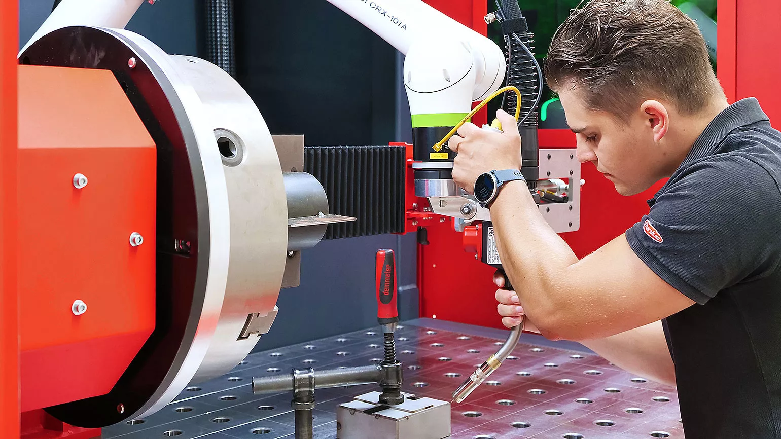

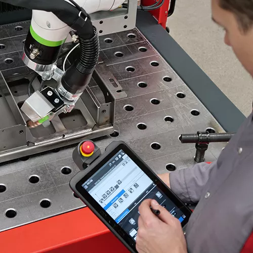

Cobot (Fanuc CRX-10iA)
- 6 axes
- Force torque sensors protect operator and components against collisions
- Grip plate mounted on the welding torch with teach buttons
4
Control - Intuitive operation and programming with tablet
- 6 axes
5
Control

1
- 6 axes
2
Tailstock (optional)
- Mounted on the linear unit
- Electro-pneumatic infeed
- Distance between centers 860 mm
3
4

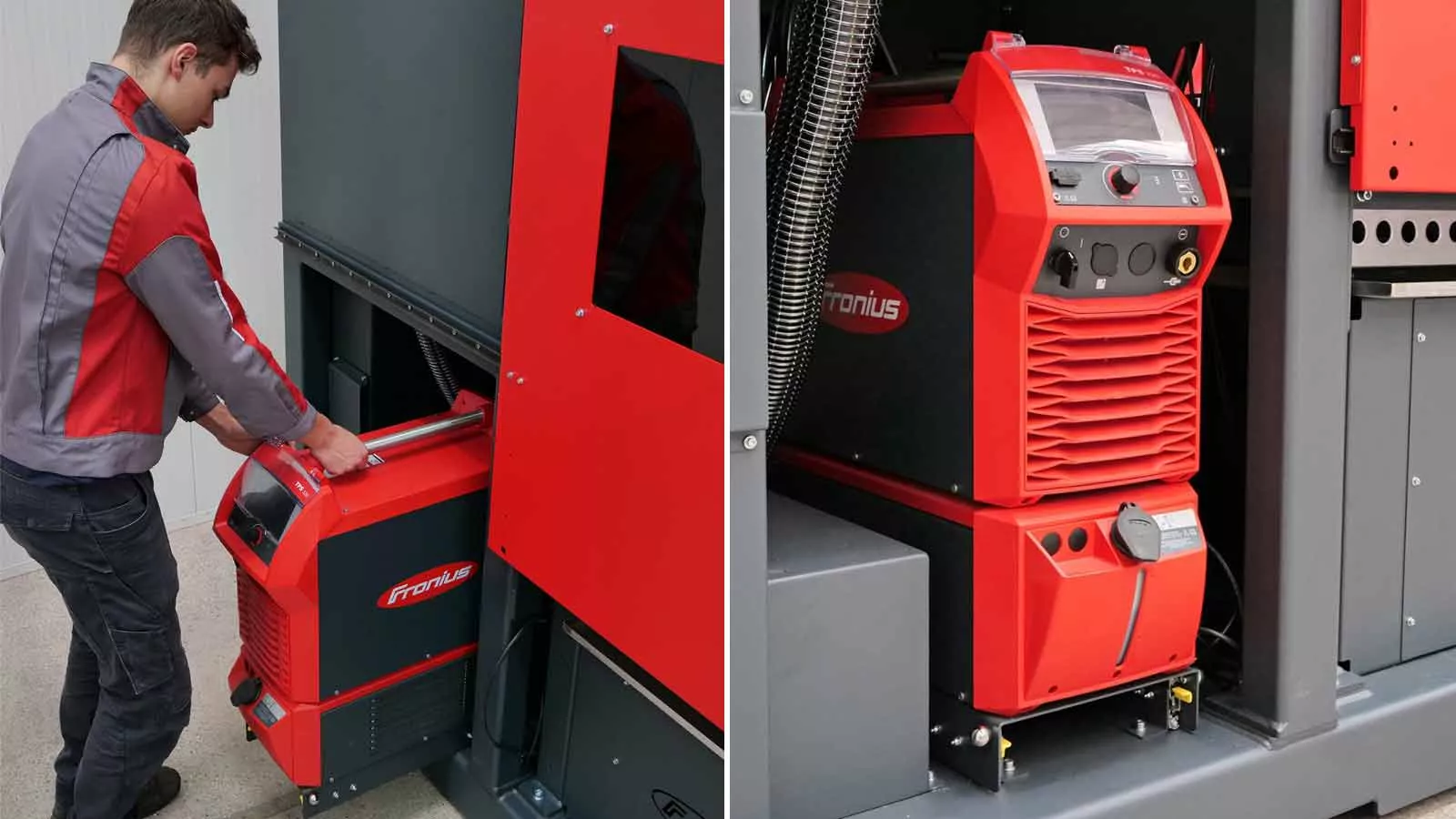

Easy maintenance: When performing maintenance work, the welding system can be easily lifted out of the welding cell without great effort, taking the strain off your back.
Features

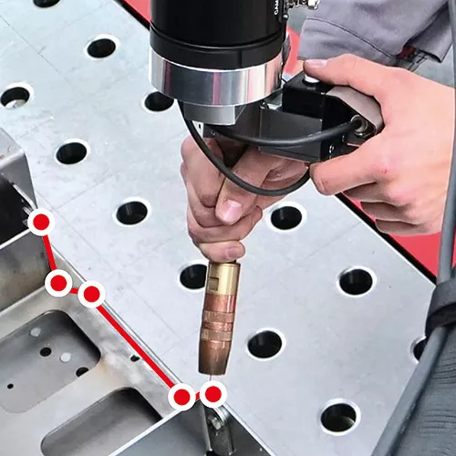

Guide & Press
Easy and Convenient Definition of Weld Paths
Guide the welding torch to the start, contour and end points of the desired welds and press the confirm button on the control handle. All points are automatically included in the welding program.
Drag & Drop
Intuitive Programming of Welding Processes
Symbols like Handle Teach, Basic Arc or Basic Wave can be easily dragged to the desired position in the graphic programming interface. This allows you to define the entire welding process without detailed knowledge of programming.

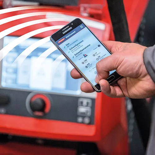

WeldConnect Ap
Welding Parameters at the Push of a Button
WeldConnect finds the relevant parameters quickly and easily. It then asks you for information such as welding process, base material, weld seam profile and shielding gas step-by-step. The wizard then uses this information to calculate the optimal welding parameters.

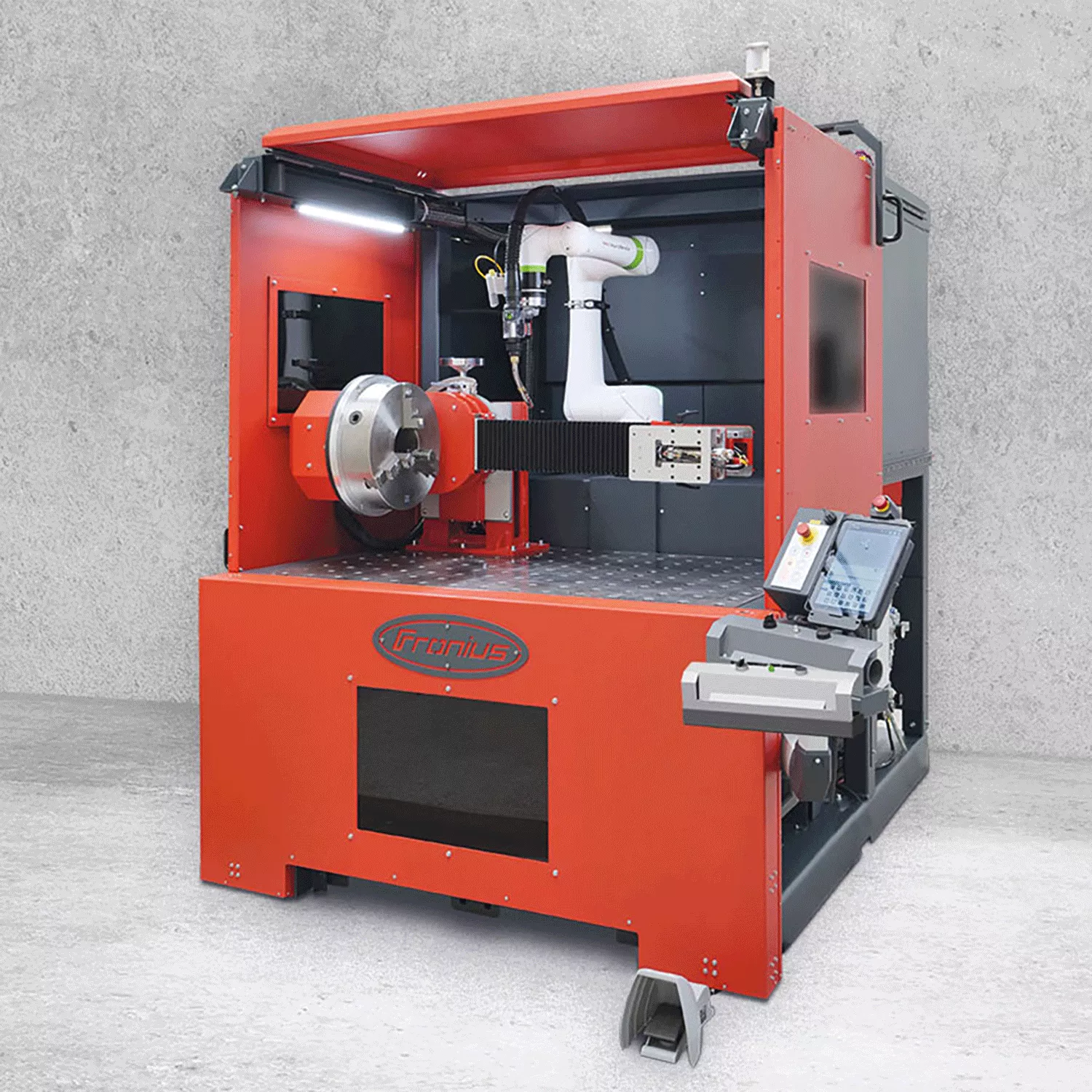

Technical Data
Dimensions & weight
  • L/D/H:  1680 x 2100 x 2240 mm
  • Weight (standard configuration):  2500 kg
Working area (max. component size)
  • Without rotary unit: 1500 x 1000 x 700 mm
  • With rotary unit: L = 860 mm, Ø = 450 mm
Robot
  • Fanuc CRX-10iA
  • Range: 1249 mm
  • Repeatability: +/- 0.04 mm
  • Max. load: 10 kg
