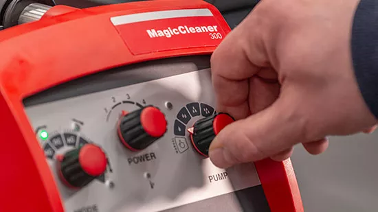

Set-up is quick and easy. All important parameters (operating mode, cleaning performance, electrolyte dosing) are adjustable on the easy-access front panel.

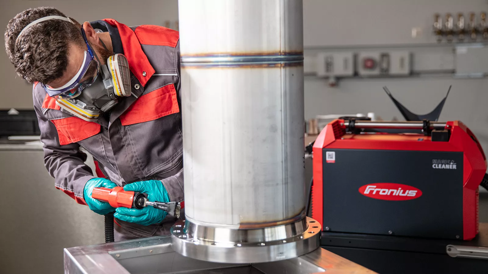

Clean and passivate in one step. MagicCleaner is the most advanced system for electrochemical cleaning units. With one machine, you can clean, polish, and inscribe stainless steel. Removepost-weld temper colouration and restore the protective passive layer at the same time.

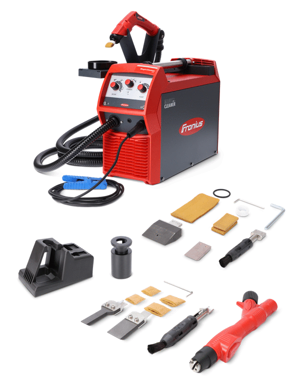

/ Cleaning torch MC300 (patented compressed air blower)
/ Cleaning torch MC150
/ Grounding cable 10 mm², 3 m
/ Torch holder MC150 & MC300
/ Basic kit: electrodes/brushes/pads
