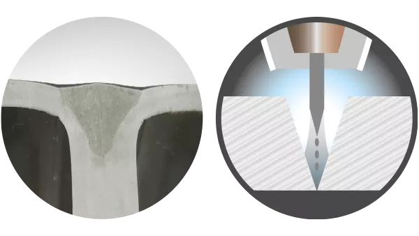

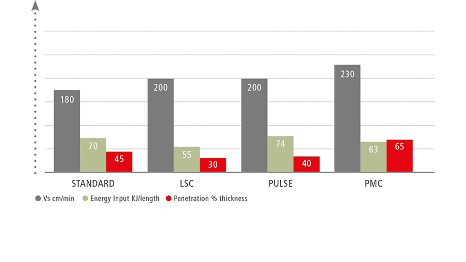

Improved weld properties
/ 15% higher welding speed*
/ 15% less energy input*
/ 60% more penetration*

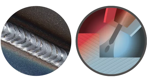

High weld quality and appearance
/ Optimized welding for vertical-up seams with the "PMC Mix" characteristic
/ 100% control with arc length and penetration stabilizer
/ TIG-like seam rippling thanks to PMC Ripple Drive
