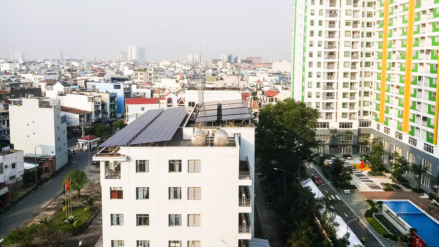

Size of installation 76.6 kWp
Inverter 3 Fronius Eco 27.0-3-S
Special features Extremely high ambient temperature, humid climate
