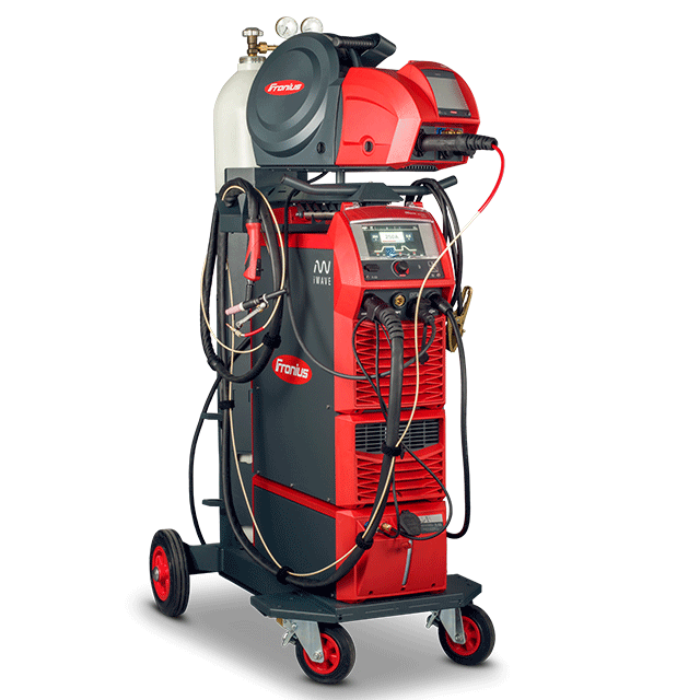

CWF 25i:
Intelligent, SpeedNet-based TIG cold wire feeder
HP 70i CWF:
Interconnecting hosepack
DynamicWire Systemperipherie HP 70i CWF
OPT/i CWF TMC B:
Option for connecting the welding torch to the cold wire feeder + connection for the interconnecting hosepack (not a mandatory option!)

Torch components
DynamicPen:
Decoupled cold wire feed system
DynamicPen
WIG CW-Feeding:
Upgradeable cold wire feed system for intelligent TIG welding torches
DynamicWire Brennerkomponente WIG CW-Feeding
TFC:
Quick-change electrode system (similar to a mechanical pencil)
DynamicWire Brennerkomponente TFC

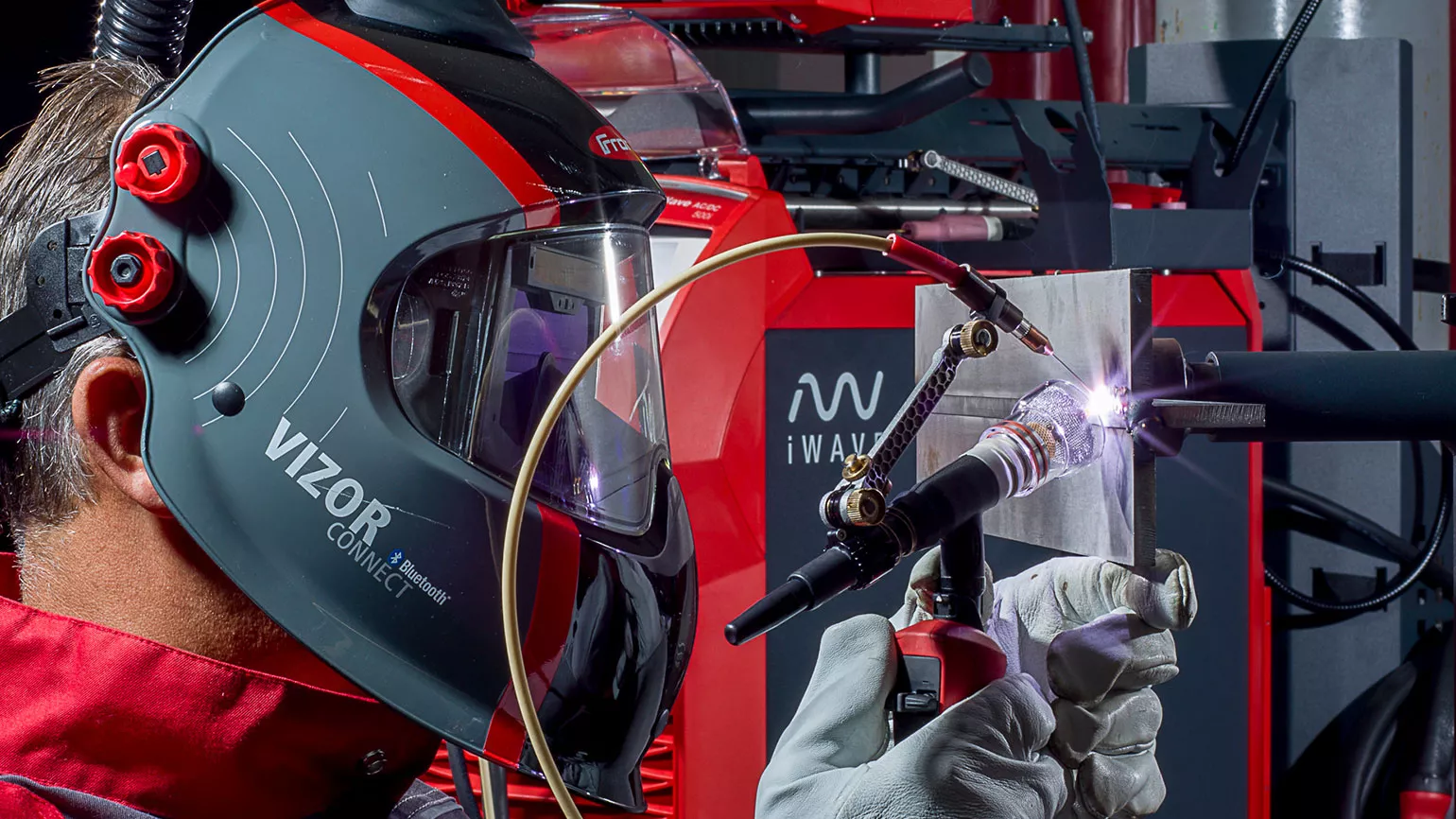

DynamicPen for maximum freedom
Use the decoupled cold wire feed system with DynamicPen and make your TIG welding work even more efficient, precise, and flexible.
  • Slim and ergonomic design for ease of use
  • Automatic wire control with voltage measurement
  • Uninterrupted welding without putting the pen down for maximum weld lengths
  • Manual and precise positioning of the wire
  • Automatic wire stop when the base material is touched
  • Best accessibility to components and perfect for narrow-gap applications
  • Suitable for demanding welding positions such as overhead work
  • Easily switch from standard cold wire feeding to DynamicPen
  • Also suitable for larger wire diameters (up to 1.6 mm)

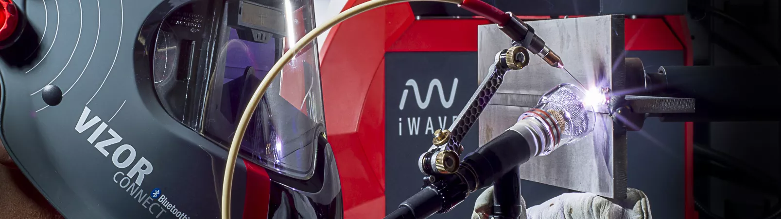

TIG DynamicWire is based on active control of the wire feed.
Thanks to the voltage measurement between the workpiece and the wire, the wire is dynamically fed in exactly the quantity that is needed at the moment. TIG DynamicWire works in synergic mode. Current and wire feed no longer have to be set separately.
