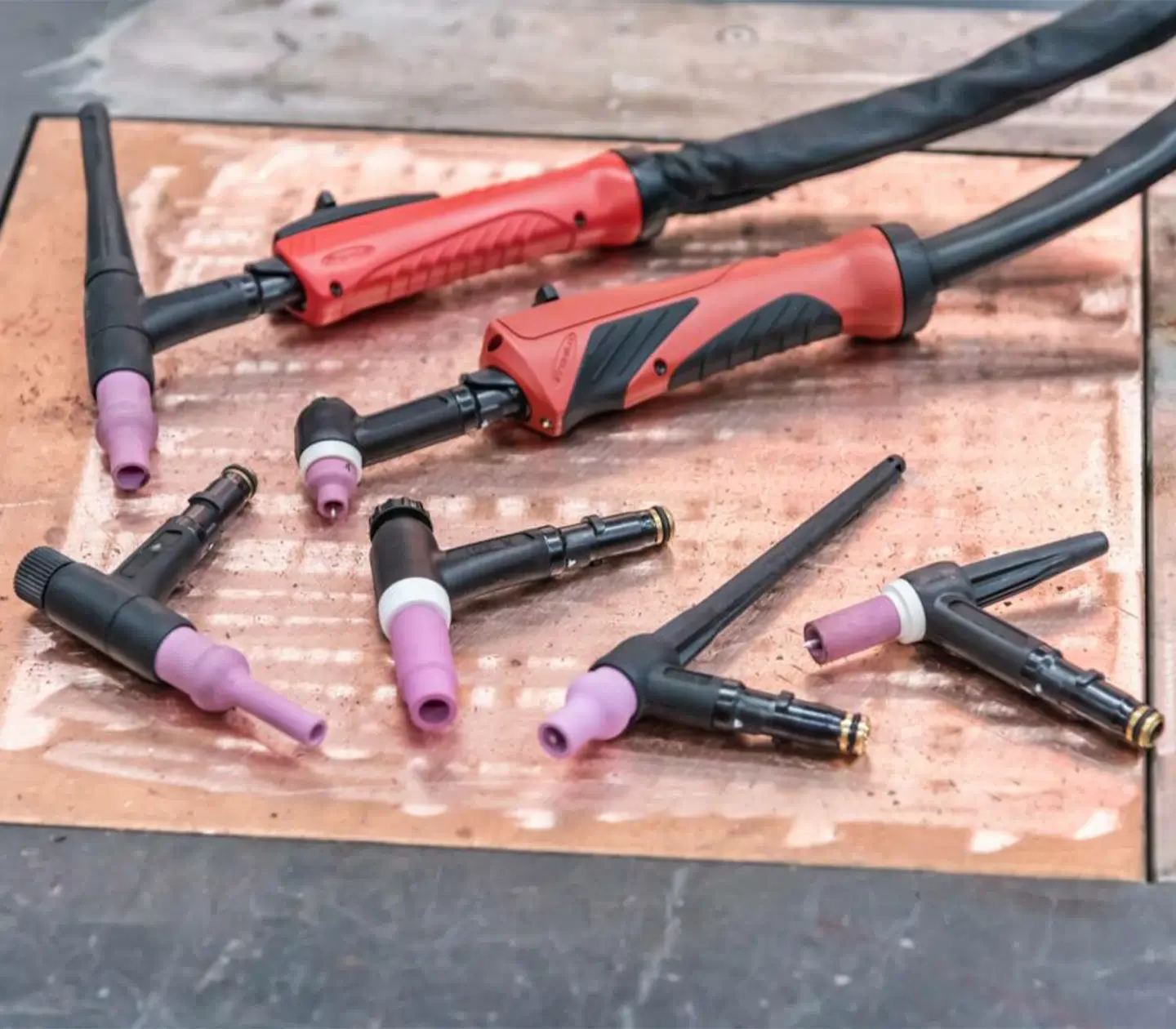

Modular design
In addition to different power categories, there are two handle versions that can be equipped with different operating elements and torch body versions.

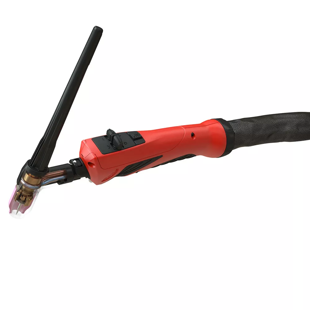

Fronius welding torches represent the perfect blend of technology and ergonomics. The ergonomic handle with non-slip components sits comfortably and securely in your hand, allowing the torch to be guided with ease. Various operating concepts take care of the most varied welding requirements. Depending on the application, welders can choose between a standard or a small handle hosepack.
Standard handle
one handle for all versions
Simple conversion* from the user interface, only one screw needs to be unscrewed.

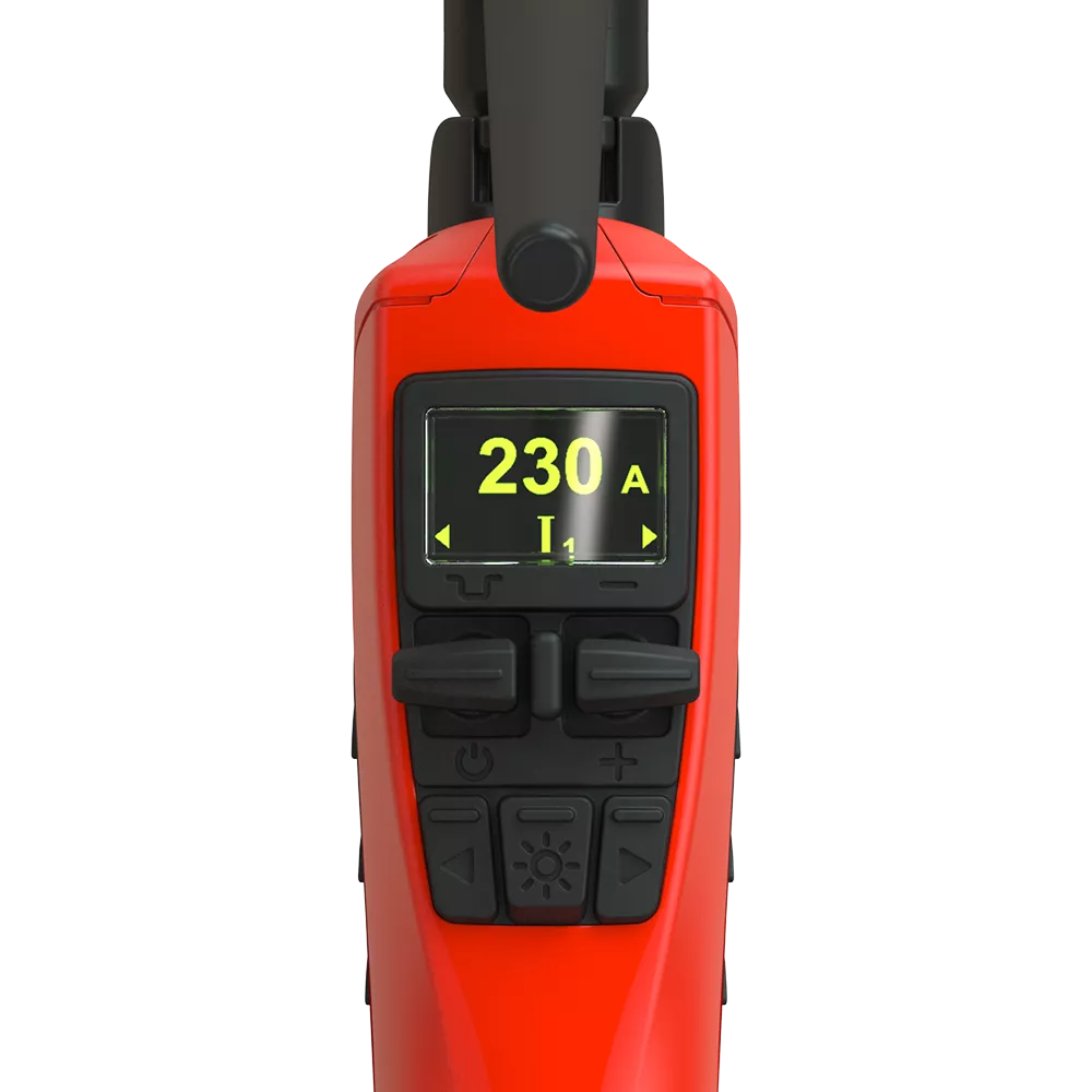

JobMaster
Start welding
1
Change the welding power using the up/down key (+/-)
2
LED can be used to light up the welding area
3
Cap-shaping in connection with the TIG AC welding process
4
Intermediate lowering in connection with 4-step operating mode (I1 > I2)
5
Display for reading essential parameters
6
Adjust the essential parameters such as main current, lowering current, or final current directly on the welding torch
7
8
1
Start welding
2
3
LED
4
Cap-shaping
5
6
Display
7
8

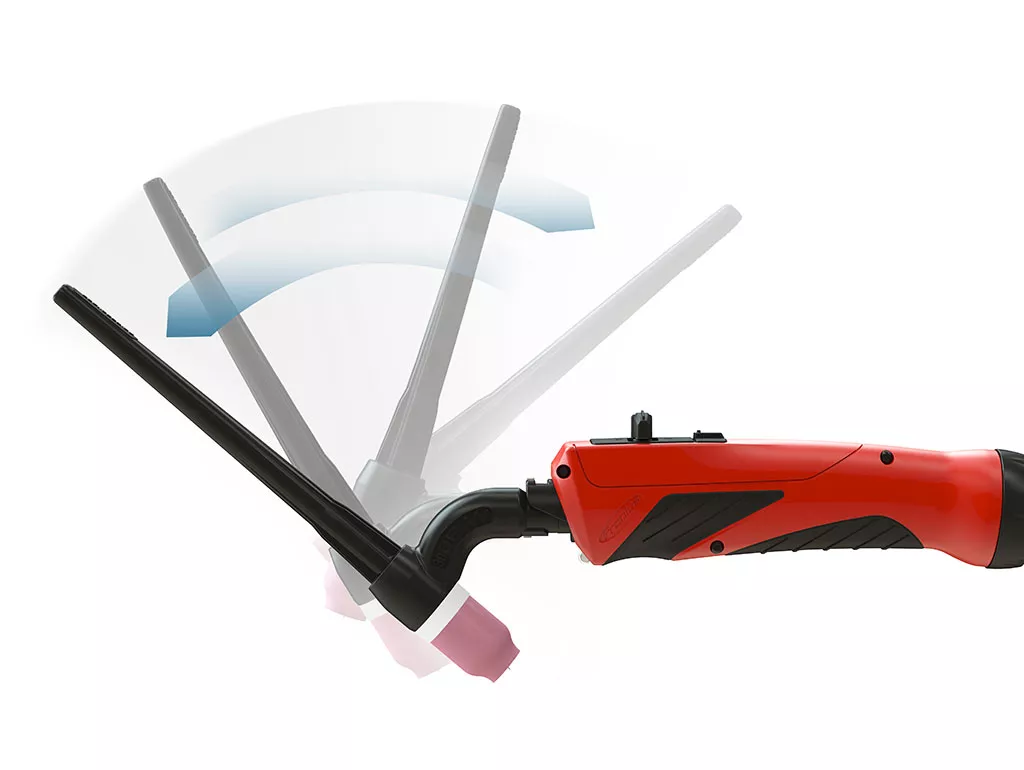

Flexible welding made easy: the modular construction of the new TIG Multilock welding torch allows the torch to be customized to suit practically any customer requirement. Multiple torch cap sizes as well as a rotatable torch body available in several lengths help overcome challenging accessibility situations and make handling the torch a breeze.
Multilock
for fast torch body changes
  • Patented interface
    The torch body can be changed quickly, easily and without the need for tools – no matter what the welding task.
  • 360°
    The torch body can be turned through 360° for an optimum welding position every time.

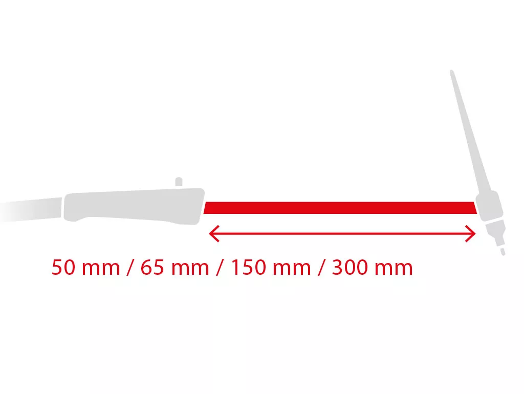

Torch body lengths
Different torch body lengths ensure maximum flexibility while welding.

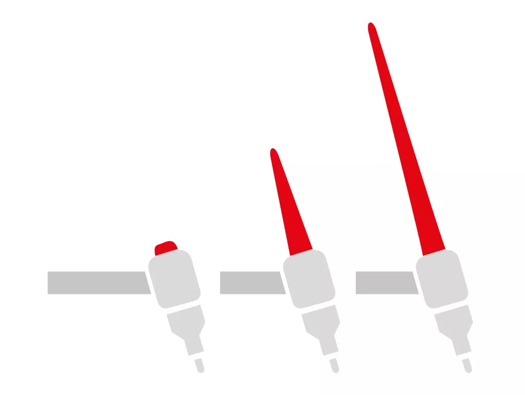

Torch caps
Depending on the application and component condition, torch caps of various sizes can be used.
Flexible torch bodies
The flexible torch bodies can be bent into the desired position for difficult to access welding points.*

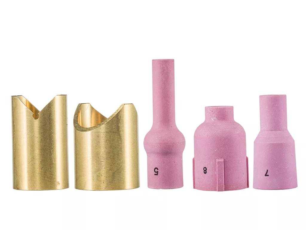

Gas nozzles
More than 80 gas nozzles available.
