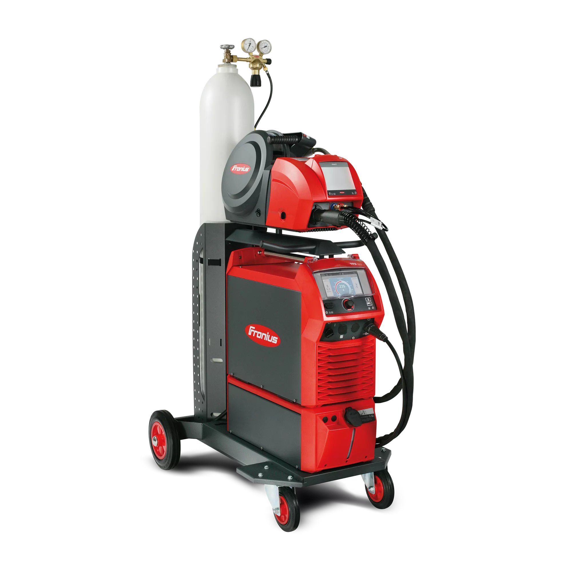

Construction machinery is made from up to 90 percent steel: Fronius welding systems are ideally suited to steel construction requirements. In the field of manual welding in particular, devices in the TPS/i Steel Edition or TransSteel series offer the ideal solution for all steel applications. Special characteristics packages increase productivity and enable reproducible welding results.
More about steel welding
Welding
System solutions for manual welding
TPS/i Steel Edition
  • More than 100 steel characteristics for standard and pulsed arcs
  • Welding data can be documented
  • Range of functions can be expanded
Transsteel 2200
TransSteel
  • Specially developed steel characteristics
  • Easy operation
  • Robust tools
