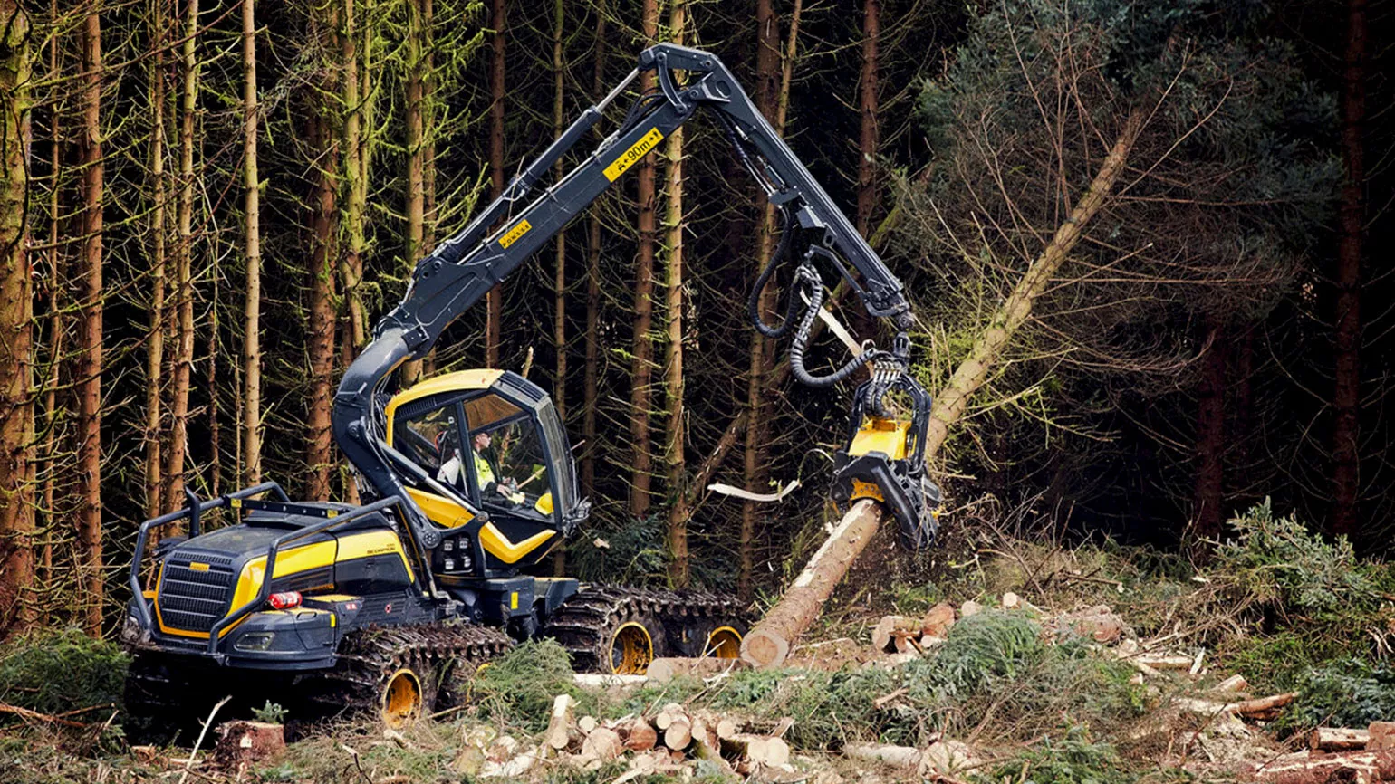

The crane boom of the enormous “ScorpionKing” logging machine from Finnish manufacturer Ponsse based in Vieremä can reach up to 11 metres into the undergrowth. The logger, which takes its name from its scorpion-like appearance, is capable of processing huge trees into transport-ready segments in mere seconds. Due to its leverage, the machine is placed under enormous mechanical loads – which is why the engineers were meticulous in their designing and testing of the machine, and the crane boom in particular. For these demanding welding operations on both the vehicle frame and crane, Ponsse relies on the quality and performance of the TPS/i.
