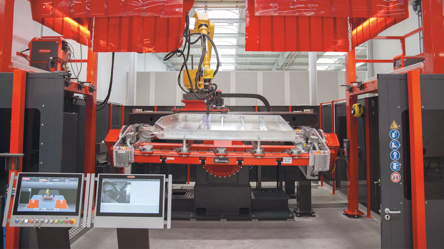

The modular system from Fronius
“Our customers’ requirements are component-specific and varied. No two Fronius robotic welding systems are the same in every detail,” explains Scherleitner. “However, to ensure system reliability and cost effectiveness, we use a modular system of tried-and-tested component units when engineering and assembling our systems.”
All components are matched to the respective welding processes and deliver a high degree of stability, repeat accuracy, and adaptability to different applications and loads. The modular system includes torch systems and torch service stations, handling robots, robot tracks, welding robots, gripper deposit systems, and positioners.

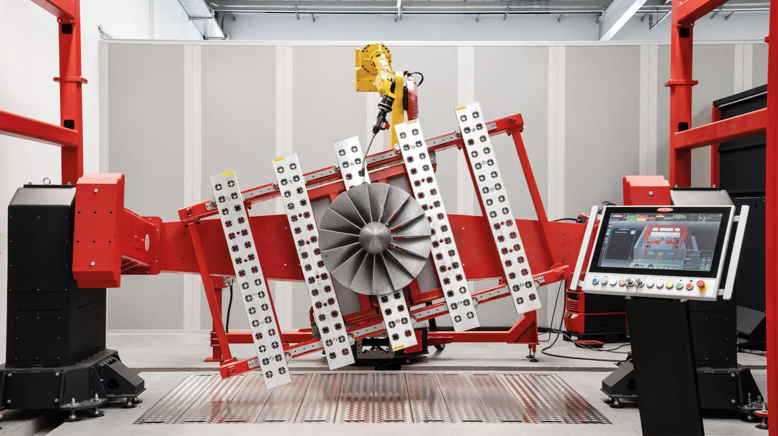

Simulation technology and sensor systems
Modern simulation technology is key when it comes to feasibility analysis and prototyping. With the Fronius Pathfinder software, welding sequences can be simulated on the welding system’s digital twin. The software identifies axis limits, calculates start and end points as well as paths, and independently sets teach points. Errors and collisions can be identified in advance and welding sequences optimized, saving time and money. In addition, the Austrian experts can simulate material distortion as part of the feasibility study and generate analyses for the correct welding sequence.
“Alongside simulation technology, we also offer advanced data management solutions,” Scherleitner explains and continues: “Furthermore, we can scan welded seams with our inspection sensor technology and evaluate them with software—in combination with WeldCube. In particular, we check whether the weld geometries are within the tolerance range over the entire length.”
During the welding process, WeldCube saves and analyzes all welding data and enables precise process monitoring and control, which ensures unbeatable quality and efficiency in production.
Precision thanks to 3D measurement
The 3D measurement of welded components takes place in a robot measurement cell, in order to check for distortion and deviations from the original CAD data. Findings from these measurements are continuously incorporated into the tests, which ensures ongoing optimization of the joining work. At the end of this process, valid welding parameters are available for series production.
