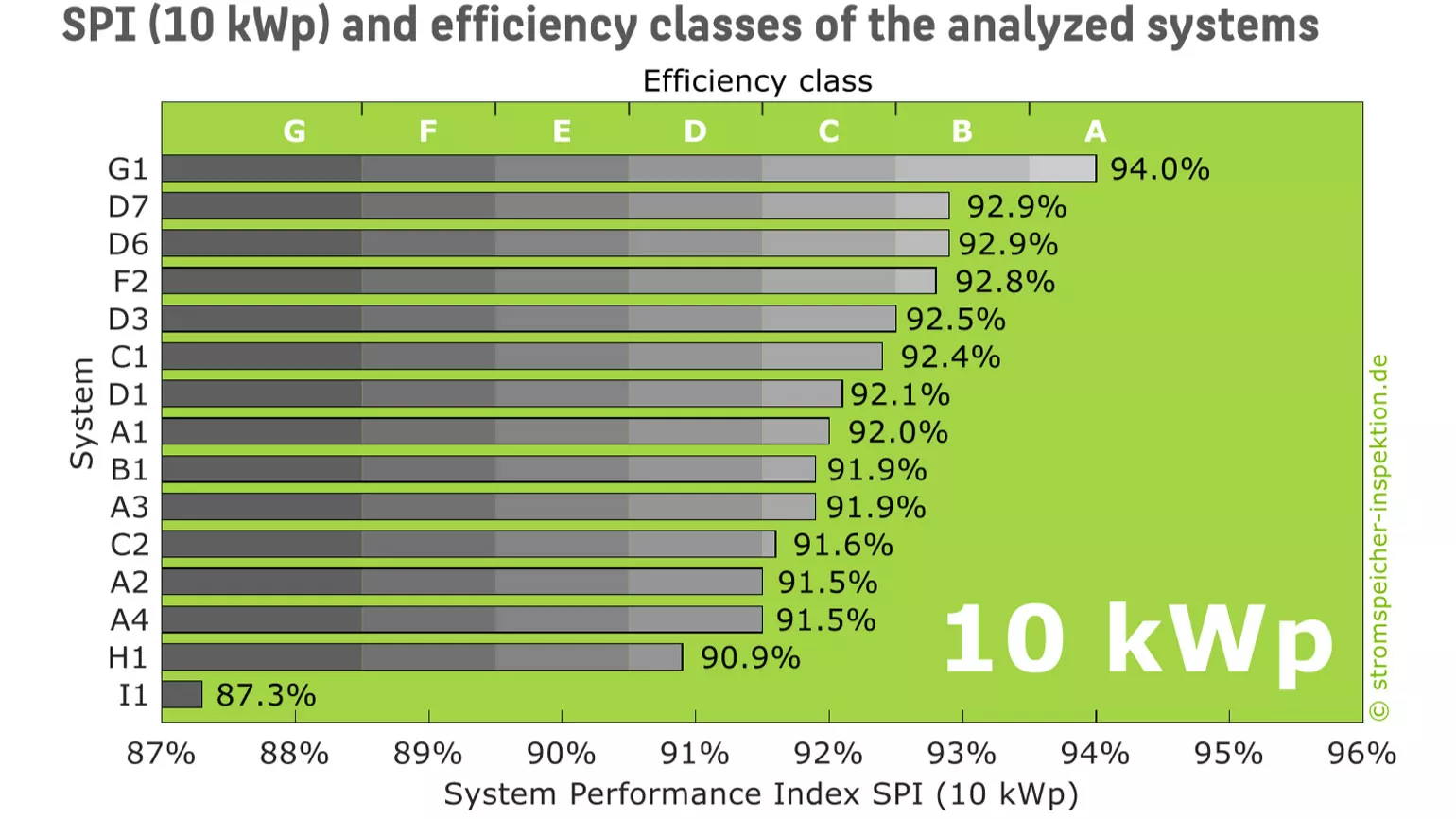

The study calculates overall efficiency using the System Performance Index, or SPI. Two different reference cases were used for the assessment: One reference system combined a 10 kWp PV system with heat pump and electric car and assumes an average annual household consumption of 5,010 kWh/a. The second, more streamlined reference case analysed the SPI for a 5 kWp PV system with the same annual household consumption as in the 10 kWp scenario.
In the 10 kWp category, the combination of the Fronius GEN24 10.0 Plus hybrid inverter and the BYD Battery Box H11.5 performed extremely well and achieved a never before seen SPI value of 94%. It was the only combination in energy efficiency class A to secure first place and left the other systems trailing by a country mile. This duo also achieved excellent results in the 5 kWp class, scoring 92.3% - close behind the winner in second place. These two systems were the only ones to achieve energy efficiency class A in this category.
Maximum conversion efficiency
The Fronius BYD combination demonstrated outstanding values in the energy conversion paths examined. These values illustrate the conversion efficiency of the PV energy produced to loads, to batteries, from the battery to loads or from the grid to the battery. Here, the hybrid inverter GEN24 Plus skilfully plays on one of its strengths, integrated Multi Flow Technology. This not only enables simultaneous energy flows in all directions, but also the AC and DC coupling of the battery storage system. In the test, the Fronius Symo GEN24 Plus inverter achieved the highest efficiency for all energy flows in comparison with the other systems.
