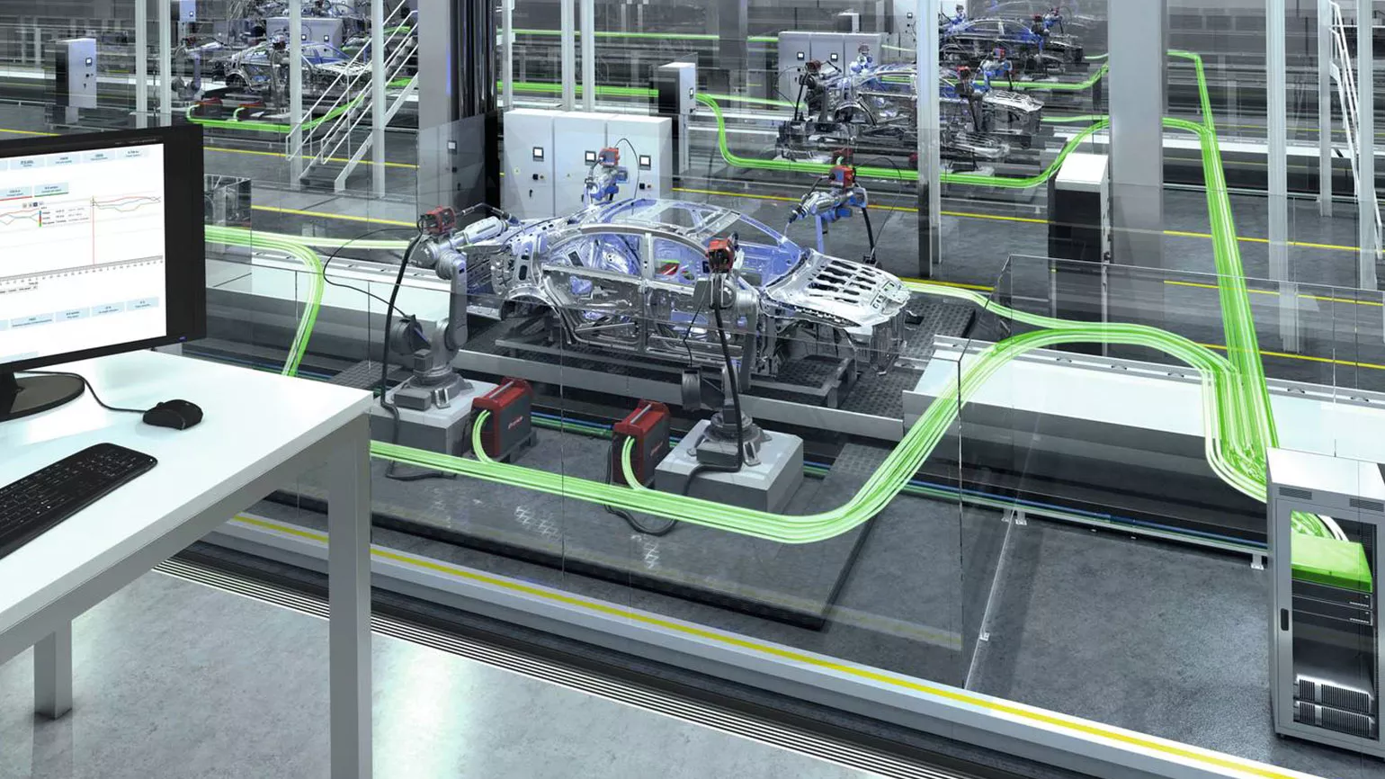

Collecting, saving and evaluating data plays a leading role in digitised and networked production. To be able to design production processes more quickly, flexibly and effectively, all relevant information must be available at all times – even across companies and locations. New technologies, however, also harbour additional expense and significant security risks. The welding technology sector has recognised the significance of big data and is developing solutions to use sensitive data effectively whilst also safeguarding against unauthorised access.
Advancing digitisation and the use of new, web-based communication technologies have long been evident in our private lives, for example in the way we listen to music or store and share photos. A similar development is also occurring in industrial manufacturing: machines, load carriers, components and goods are being linked together to form overarching valueadded chains, whose elements communicate and seamlessly interact with each other. For all this to be possible however, all the relevant product and process data must exist in digital form and be made available to all the stations involved.
