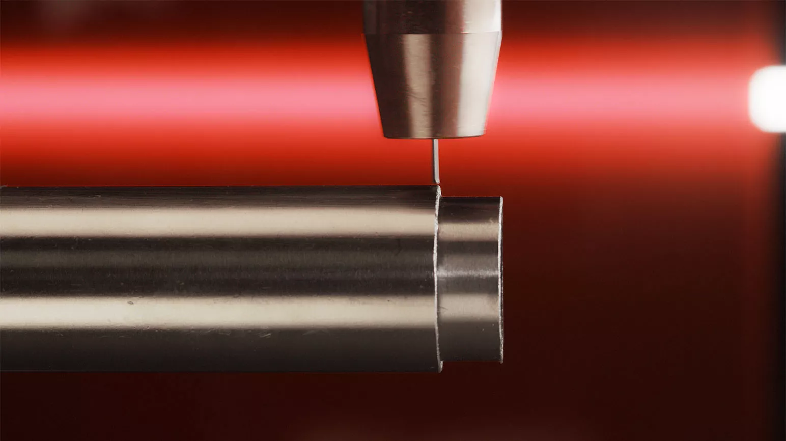

WireSense—unique precision thanks to CMT technology
What’s so clever about WireSense is its simplicity. “Adding special controller software to our highly sensitive and dynamic CMT drive turns the welding wire into a sensor that can identify contours or air gap deviations on the component,” reports Philipp Schlor, Strategic Product Manager, Industrial Welding Solutions, at Fronius International. To ensure precision control of the welding wire, the Fronius welding system simply needs to be equipped with a CMT-ready system. The Welding Package, i.e., the CMT (Cold Metal Transfer) welding process itself, is not required.
CMT-ready systems consist of a wirefeeder on a wire drum or wire spool, a wire buffer, and a CMT Robacta Drive, in other words a second wirefeeder on the torch itself. A reversing wire movement, which takes place at around 100 Hz, causes the electric motor in the drive unit to scan the metal surface with the wire. It is this high-frequency scanning of the workpiece that provides the necessary levels of precision. Even if the surface being scanned is uneven, such as the sheets lying at an angle, the edge can still be detected and measured without any difficulty.
Detecting the edge position and air gap height
“Our revolutionary WireSense technology uses the scanning function of the reversing CMT wire movement to determine the exact position of the component and edge as well as air gap heights. Steel, stainless steel, and aluminum sheets from 0.5 to 20 millimeters thick can be scanned quickly and precisely,” emphasizes Schlor. Every raising and lowering operation on the component can be recorded extremely accurately relative to a reference point specified at the start of the scanning process. In just seconds the robot has compared the taught positions with those measured, or in other words it has checked the stored values against the actual position data. If it detects any differences, the course of the seam is adjusted accordingly in the robot’s coordinate system and the weld is produced in the right place.
“WireSense opens up a multitude of possibilities for robot integrators to identify high-quality solutions for challenging welding tasks,” reveals Schlor: “The edge being welded doesn’t necessarily have to be detected. Any fixed reference edge on the component, such as the component edge or a notch, can serve as the starting point from which welding is to take place at a certain distance. This enables even difficult-to-detect parts, like a rounded sheet, to be welded at the desired position.”

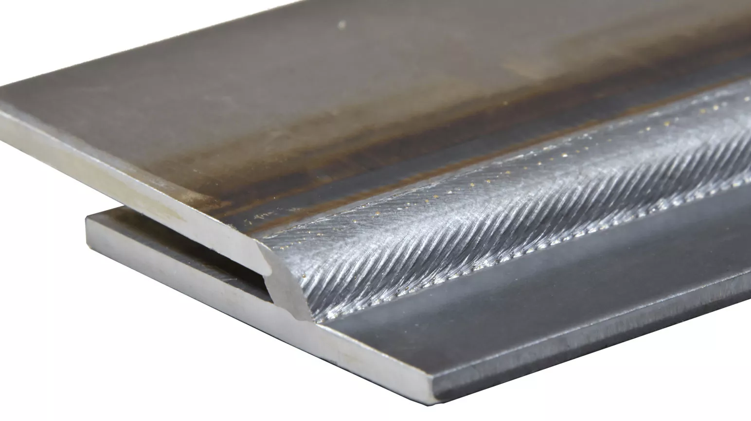

Reliably bridging air gaps
With WireSense the wire electrode becomes a height sensor, allowing air gaps to be determined on lap joints using the precisely measured sheet edge height. To achieve perfect results it is possible to specify in advance which jobs stored on the Fronius welding system should be called up for different air gap sizes. This allows the robot to always respond appropriately and weld with the welding parameters that are ideal for the air gap dimension in question, preventing welding errors and time-consuming rework.
