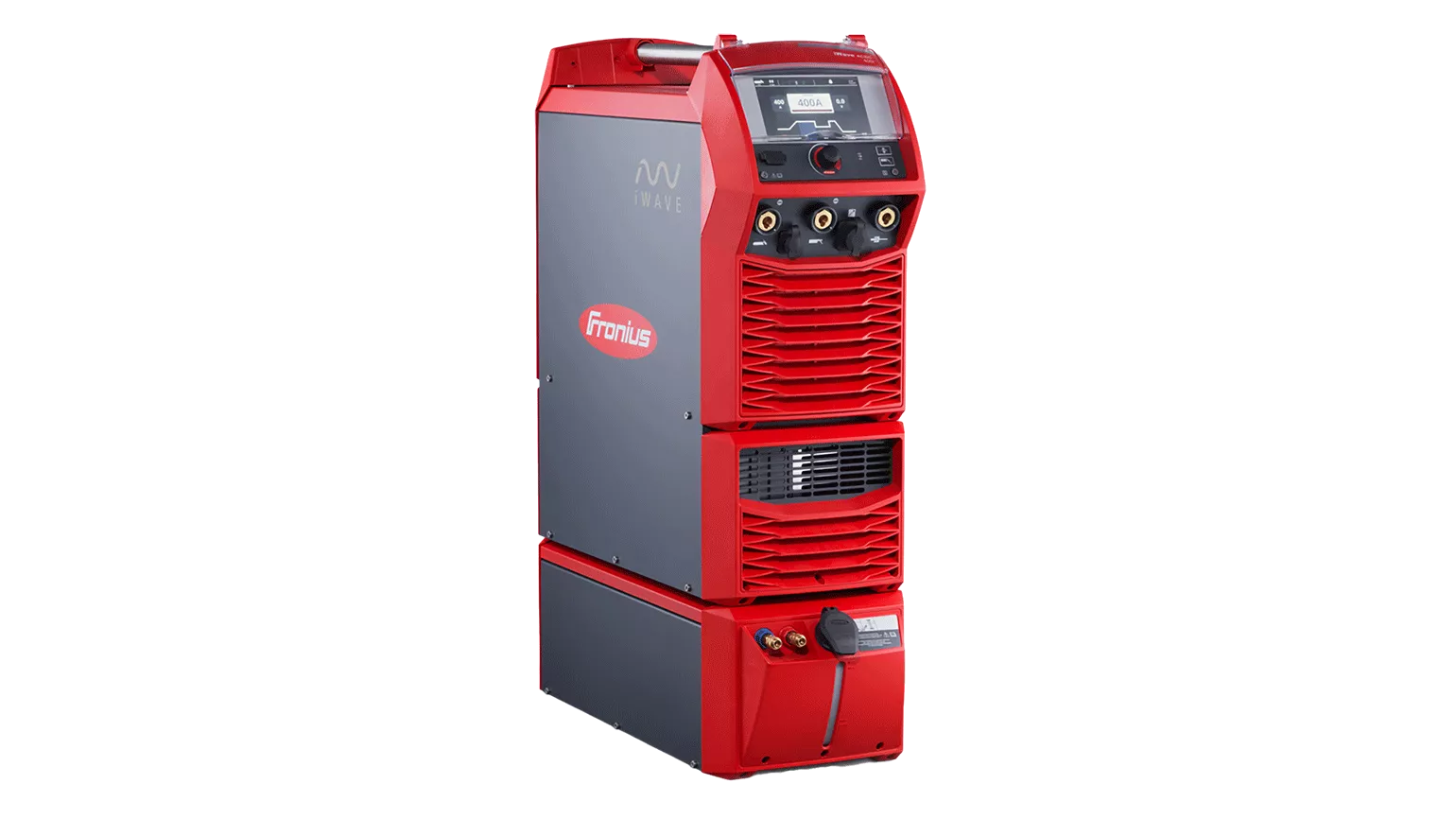

GENERAL DATA
Mains voltage3 x 400 V
Mains voltage tolerance+/-15 %
Welding current min.3 A
Welding current max.400 A
Welding current / Duty cycle [10min/40°C]400A / 40%
Welding current / Duty cycle [10min/40°C]360A / 60%
Welding current / Duty cycle [10min/40°C]320A / 100%
Operating voltage min.10,1 V
Open-circuit voltage96 V
Protection classIP23
Dimension / l
2,32 ft
Dimension / b
11,81 in
Dimension / h
2,43 ft
Weight151,68 lbs
TECHNICAL DATA
Contact
Want to find out more about this product?
More information about the features of the iWave welding machine
The Trial License allows you to test all welding packages and options for some arc hours
iWave AC/DC - function overview
 Functions
iWave 190i
iWave 230i  iWave 300i
iWave 400i
iWave 500i
 Pulse welding x x x x x
 RPI on x x x x x
 RPI auto x x x x x
 SoftStart
 (touchdown ignition)
x x x x x
 HF ignition x x x x x
 Touch HF ignition x x x x x
 TIG Comfort Stop x x x x x
 Arc break voltage x x x x x
 Automatic
 cap-shaping
x x x x x
 Waveform setting
 (AC/DC)
x x x x x
 Tacking x x x x x
 Synchronized welding x x x x x
 Automatic gas
 post-flow
x x x x x
 CEL mode x x x x x
 CycleTIG x x x x x
 Multiprocess
 (TIG, MMA)
x x x x x
 Multiprocess PRO     x x x
 Generator-compatible x x x x x
 Mulitvoltage
 120/230V
x x x x x
 Multivoltage
 200-600V
x x x
 Cooling type  Gas-cooled  Gas or
water-
cooled
 Gas or
water-
cooled
Gas or
water-
cooled
 Gas or
water-
cooled
 Connectivity
 (WLAN, NFC,
 Bluetooth)
x x x x x
 Ethernet and
 Speednet
as standard
Ethernet
optional
Ethernet
optional
Ethernet and
Speednet as
standard
Ethernet and
Speednet as
standard
 Ethernet and
Speednet as
standard
