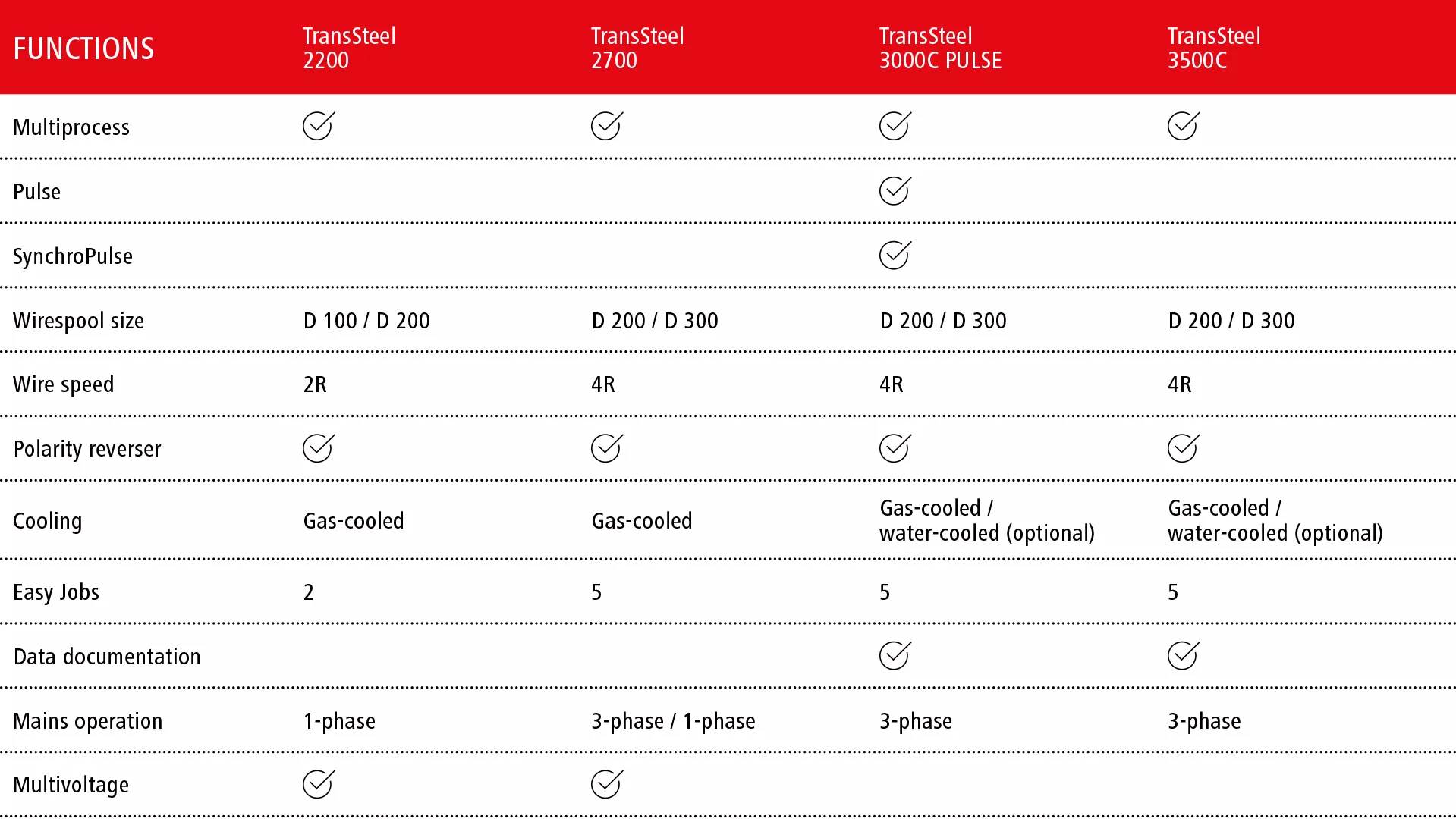

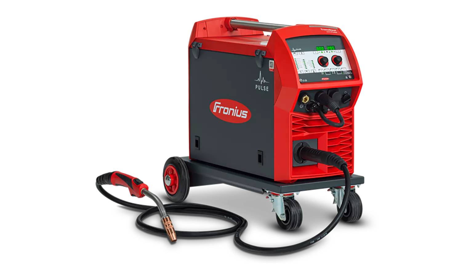

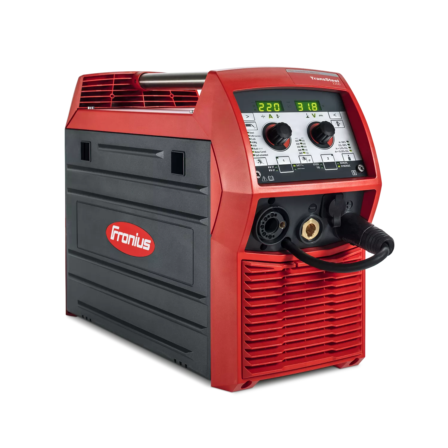

TransSteel Compact
No matter what the welding task - MIG/MAG, TIG and electrode welding with just one device.

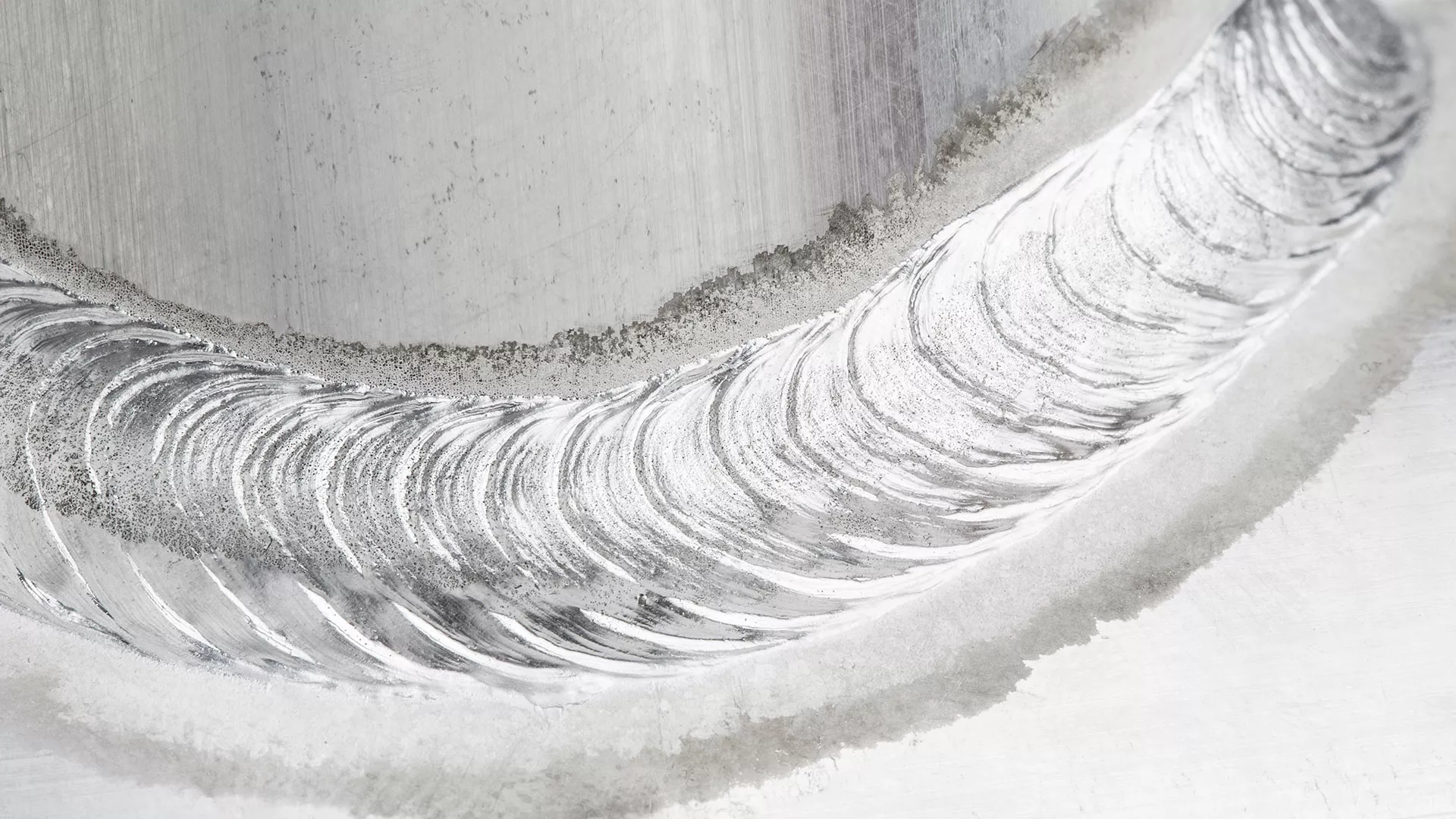

SynchroPulse
Seam rippling for aluminum alloys
The “SynchroPulse” option is recommended for the welding of aluminum alloys when a rippled seam appearance is required. This effect is achieved by modifying the welding power between two operating points.

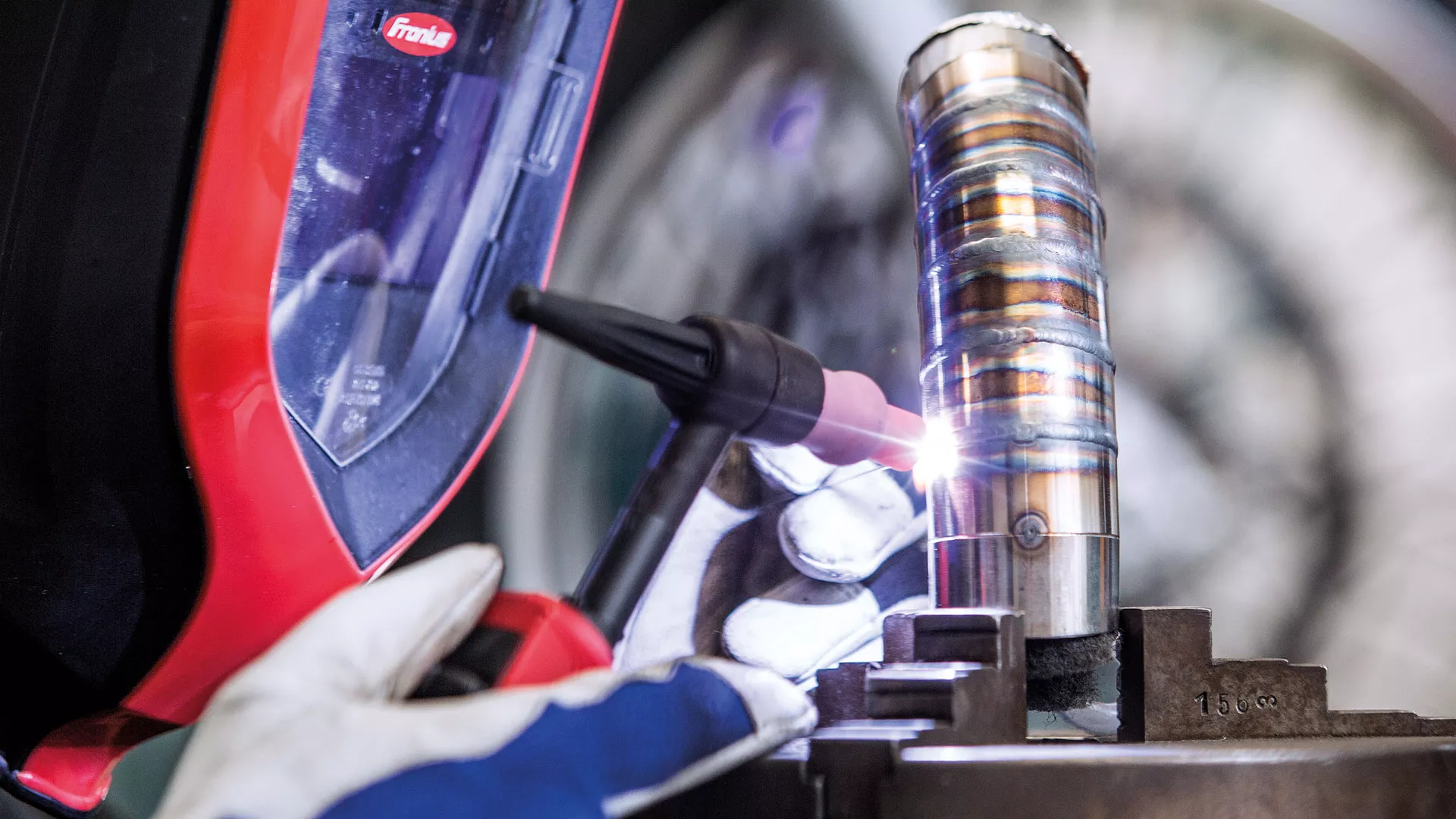

The TIG welding functions
TIG
Pulse welding
Pulse welding is primarily used for out-of-position welding or when welding especially thin materials. The pulse setting range is from 1 Hz to 990 Hz.
TAC
Tacking function
The weld pool is made to oscillate by means of pulse currents. This makes it easier to tack components together and reduces the tacking time. The pulsed arc facilitates the process with very thin materials, since the temperatures are slightly lower in the phases with less current.
- Time saving of up to 50% for the usercompared to conventional tacking
- Fast tacking points without burning off the edges
- Minimal temper coloration at the tacking points
- Spot function
Touchdown ignition
The highly accurate touchdown ignition is on a par with high frequency ignition and contributes towards user-friendliness.
Gas pre-flow time + Gas post-flow
TransSteel automatically calculates the duration of the optimal gas post-flow time according to the set welding current. This improves the gas shield of the weld seam end and tungsten electrode.
