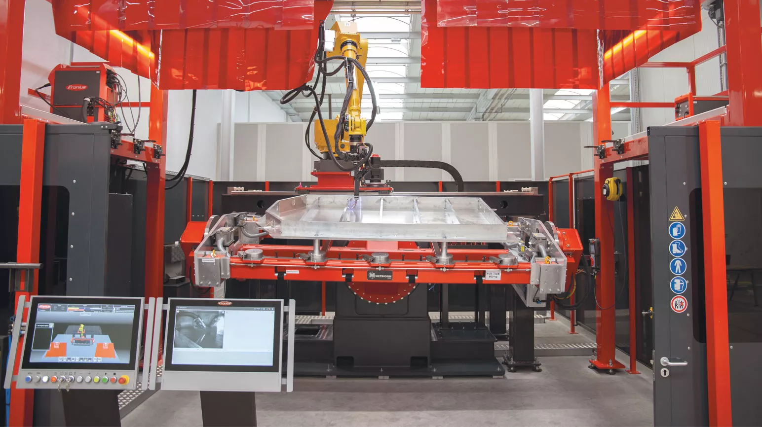

Feasibility studies are initially carried out at the Austrian site in Wels, followed by prototype production if requested. This requires that the client submit their welding specifications as well as the 3D data of components and clamping devices. Fronius performs a virtual analysis of this information, in order to draw conclusions about weldability, accessibility, and cycle time. Problems that arise are discussed together with the customer and optimization and solution options are developed. The clear aim of the development work is to create future-proof, state-of-the-art products.
Complete service package—from the feasibility study to the finished product
As soon as valid welding data is available and the first prototypes have been successfully welded, Fronius develops a production concept and, if requested, takes over production of the pilot series as well as series production. If series production takes place at the customer’s premises, Fronius can also design, build, and supply customized robotic welding systems from a single source on request.

“Our customers’ requirements are component-specific and varied. No two Fronius robotic welding systems are the same in every detail,” explains Scherleitner. “However, to ensure system reliability and cost effectiveness, we use a modular system of tried-and-tested component units when engineering and assembling our systems.”
All components are matched to the respective welding processes and deliver a high degree of stability, repeat accuracy, and adaptability to different applications and loads. The modular system includes torch systems and torch service stations, handling robots, robot tracks, welding robots, gripper deposit systems, and positioners.
