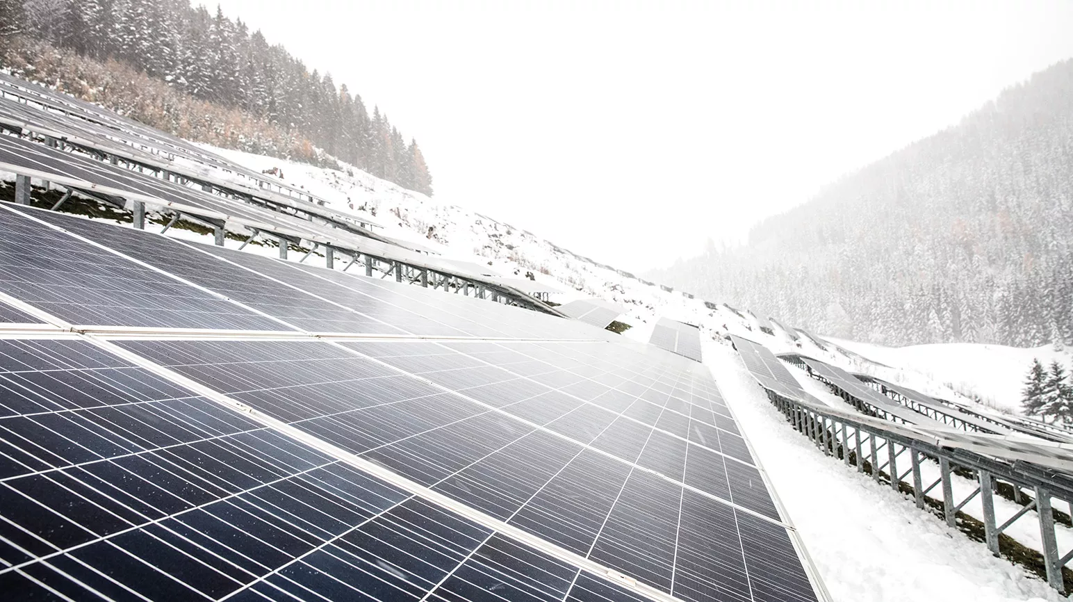

Snow on the solar modules
Your PV system is also well-equipped to deal with snowfall – regular solar modules can easily withstand a pressure of 2400 pascals (equivalent of 240 kg/m2). For regions with increased intensity, there are even modules that can be loaded with 8000 pascals.
On sloped roofs, however, the snow slides down very quickly of its own accord; whereas on flat roofs it is important to keep an eye on the load bearing reserve during periods of heavy snowfall so as not to compromise the structural stability.
Did you know that enough sunlight to produce electricity can even penetrate a 15 cm covering of snow?
Despite snow on the solar modules, diffuse light can still hit them allowing current to flow.
At an angle of 30 to 35° the snow slides down quickly in any case. This process is accelerated by the heat generated as soon as a small part of the panel is exposed.
