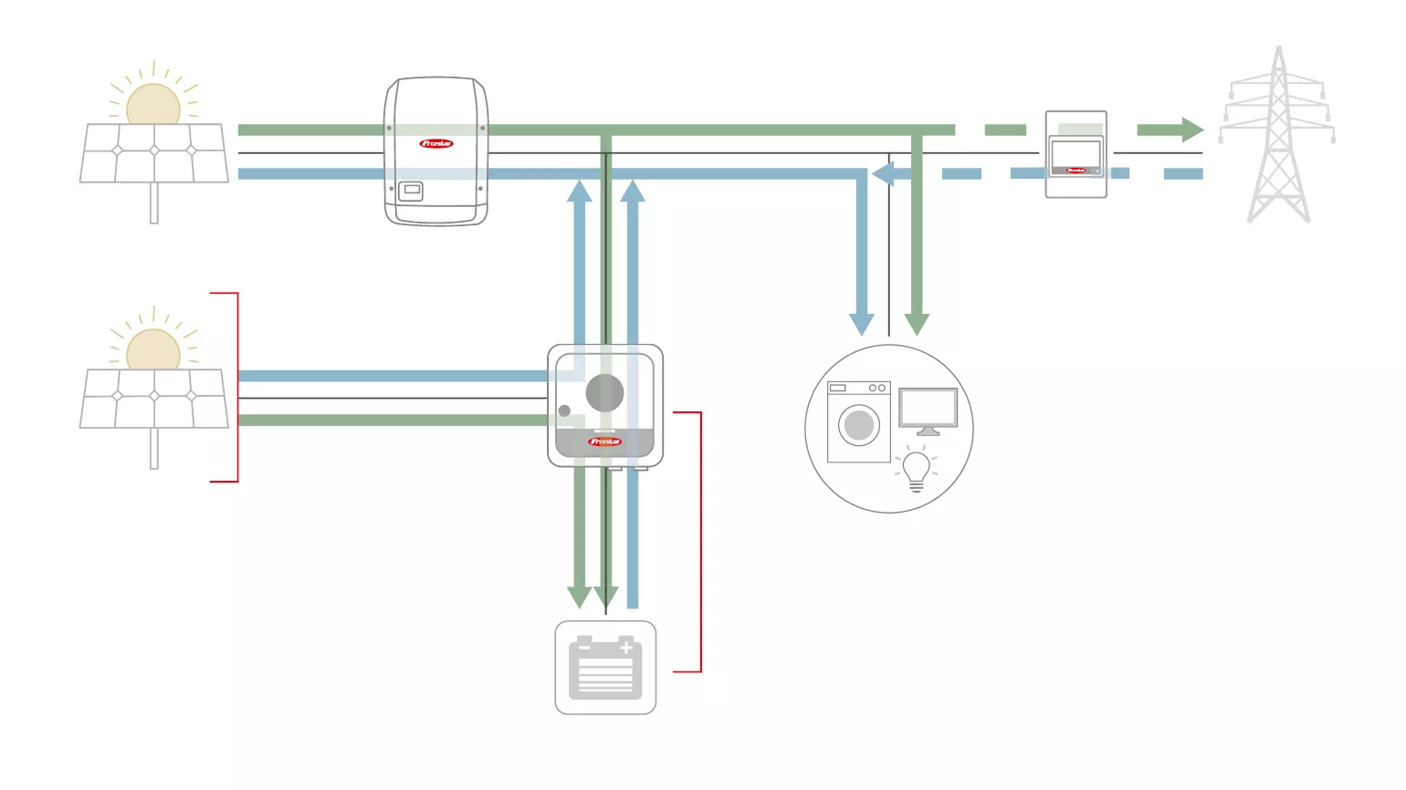

Conventional inverters only allow one energy flow at a time; simultaneous current flows are not possible. This means the energy generated is not used optimally. Fronius inverters with Multi Flow Technology can control different energy flows in parallel and in all directions. This has many advantages.
  • Maximum efficiency with DC-coupled batteries
  • DC and AC coupling: integration into an existing PV system
  • Reliable power supply even during a power failure
  • Control of battery charging and battery usage

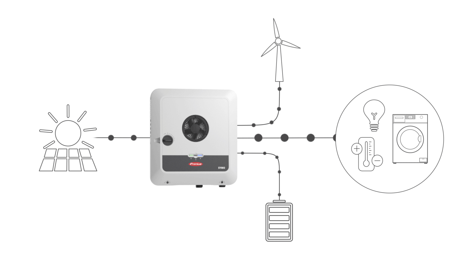

THE ENERGY FLOWS IN AN ENERGY STORAGE SYSTEM
The PV generator can supply loads in the household and charge the battery at the same time. If there is a surplus, it can be fed into the grid.
Loads in the household can be supplied by the PV generator and the battery at the same time.
If there is a surplus, loads are supplied and the battery is charged in parallel. When there is a consumption situation, power is supplied by the PV generator and the battery.
The inverter can use energy from an additional AC source to charge batteries, for example, from wind turbines or existing PV systems.
The inverter controls the energy flows in the storage system.

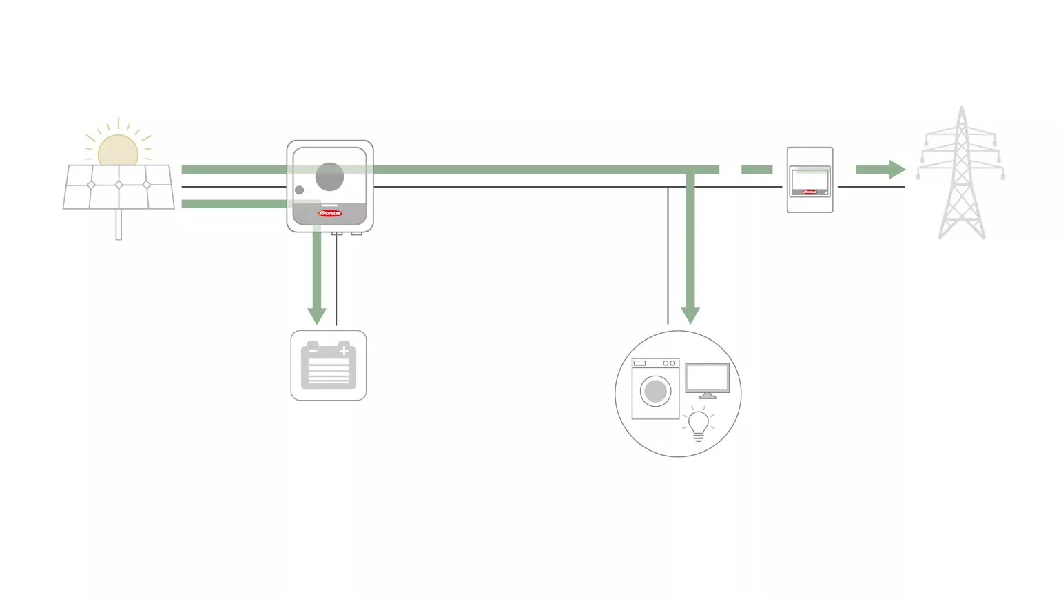

HIGH SELF-CONSUMPTION RATE THROUGH SIMULTANEOUS ENERGY FLOWS
Multi Flow Technology allows simultaneous energy flows in all directions, which means less grid usage and less feed-in – i.e. lower costs and a higher yield.
In this application, for example, a Fronius Symo GEN24 6.0 Plus with PV production of 6 kW can supply the household with 3 kW and at the same time use the other 3 kW to charge the battery*.
*possible with BYD Battery-Box Premium HVS/HVM

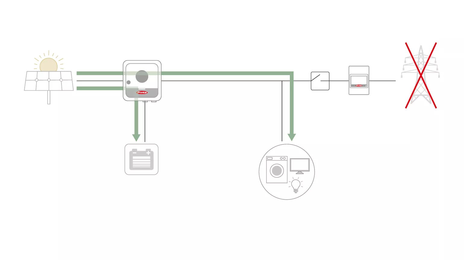

RELIABLE POWER SUPPLY EVEN DURING A POWER FAILURE
In backup power mode, for instance during a power failure, Multi Flow Technology provides a backup power supply from the PV system and the battery. The PV system can supply the household with solar energy even if the battery is already discharged.
In this application example, in the event of a power failure, the loads in the household are supplied with power and the battery is charged at the same time*.

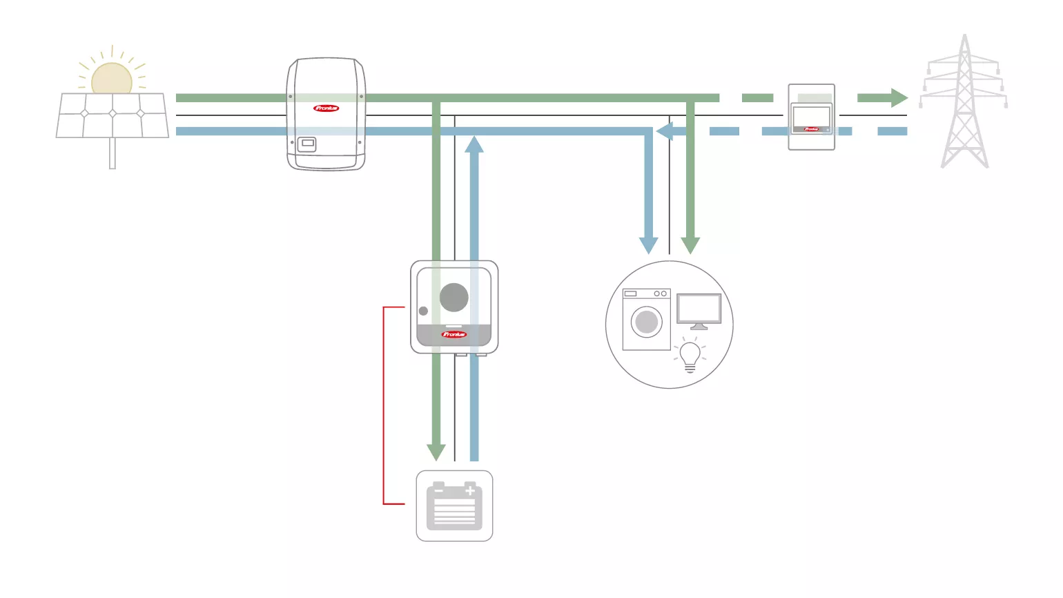

EXPANDING THE PV SYSTEM TO INCLUDE A STORAGE UNIT AND A HYBRID INVERTER
Owners of a PV system without a storage unit can retrofit their PV system with one and use the advantages of the Multi Flow Technology for their own benefit.
In this application example, when there is a surplus (green line), the loads in the household are supplied with power and the battery is charged at the same time. When there is a consumption situation (blue line), power is supplied by the PV generator and the battery.
ENLARGEMENT OF THE PV SYSTEM WITH AC COUPLING
Multi Flow Technology allows both DC and AC coupling of the storage system. It is therefore possible not only to integrate the storage solution into existing PV systems, but also to incorporate small wind generators or mini-cogeneration units into the storage system.
In this application example, when there is a surplus (green line), the loads in the household are supplied with power and the battery is charged from the DC and the AC side. When there is a consumption situation (blue line), power is supplied by the DC and AC-side PV generator and the battery

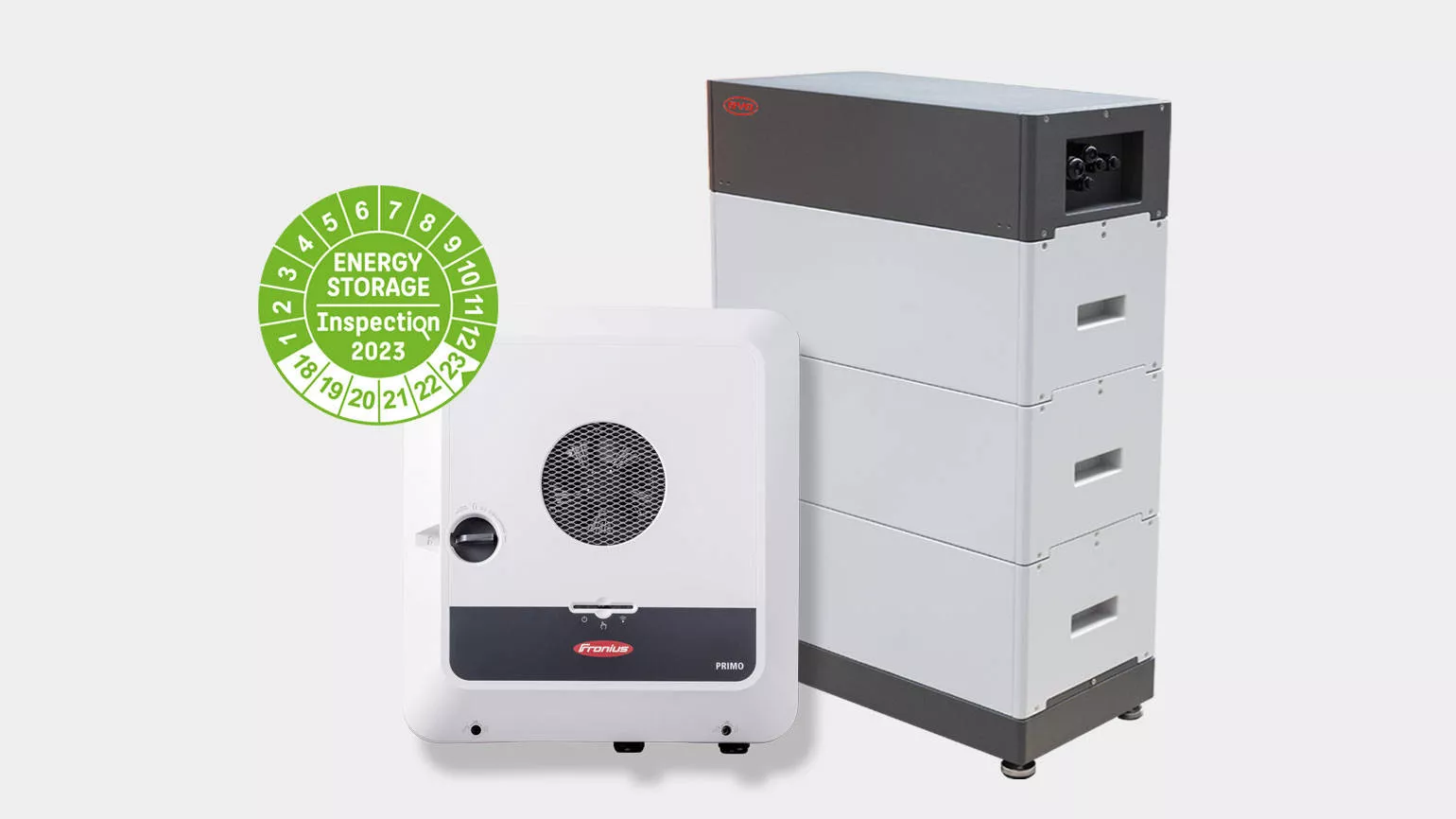

FRONIUS AGAIN WITH TOP RESULTS
Fronius GEN24 Plus combined with BYD Battery-Box Premium HVS has earned top rankings for the fourth year in a row in the 2023 Energy Storage Inspection. The System Performance Index (SPI) improved further from the previous year, confirming the extreme efficiency of Fronius hybrid inverters in combination with battery storage systems – all of which helps PV system owners achieve greater independence. This makes Fronius one of only two manufacturers to achieve efficiency class A with its products during the inspection.
