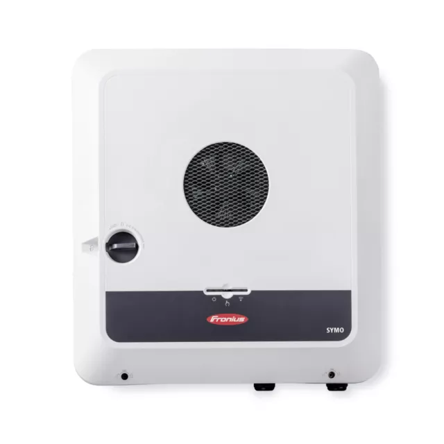

Fronius GEN24*
integrated basic backup power function
  • Primo (single phase) 3–6 kW
  • Symo (three phase) 3–10 kW
Fronius GEN24 Plus**
two backup power options/battery connection

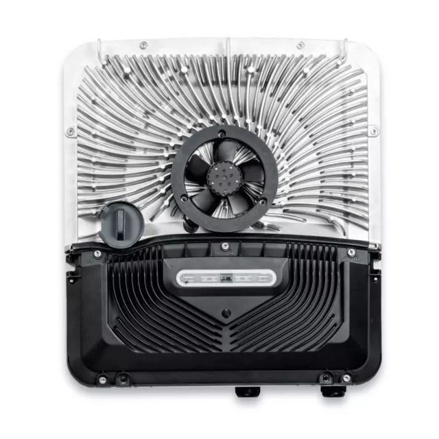

Long service life
/ Active cooling technology extends the service life of the inverter
/ Reliable independent energy supply
/ Investment security for customers

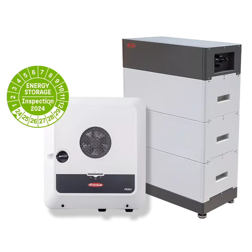

Fronius comes in top for fifth time
Fronius GEN24 Plus and BYD Battery-Box Premium: This combination once again achieves top rankings at the Energy Storage Inspection 2024. The Energy Storage Inspection is carried out annually by HTW Berlin and is considered Europe’s most important study on the efficiency of PV storage systems. As part of this inspection, the duo made a great impression for the fifth time in a row thanks to its exceptional efficiency.
More about the energy storage inspection
