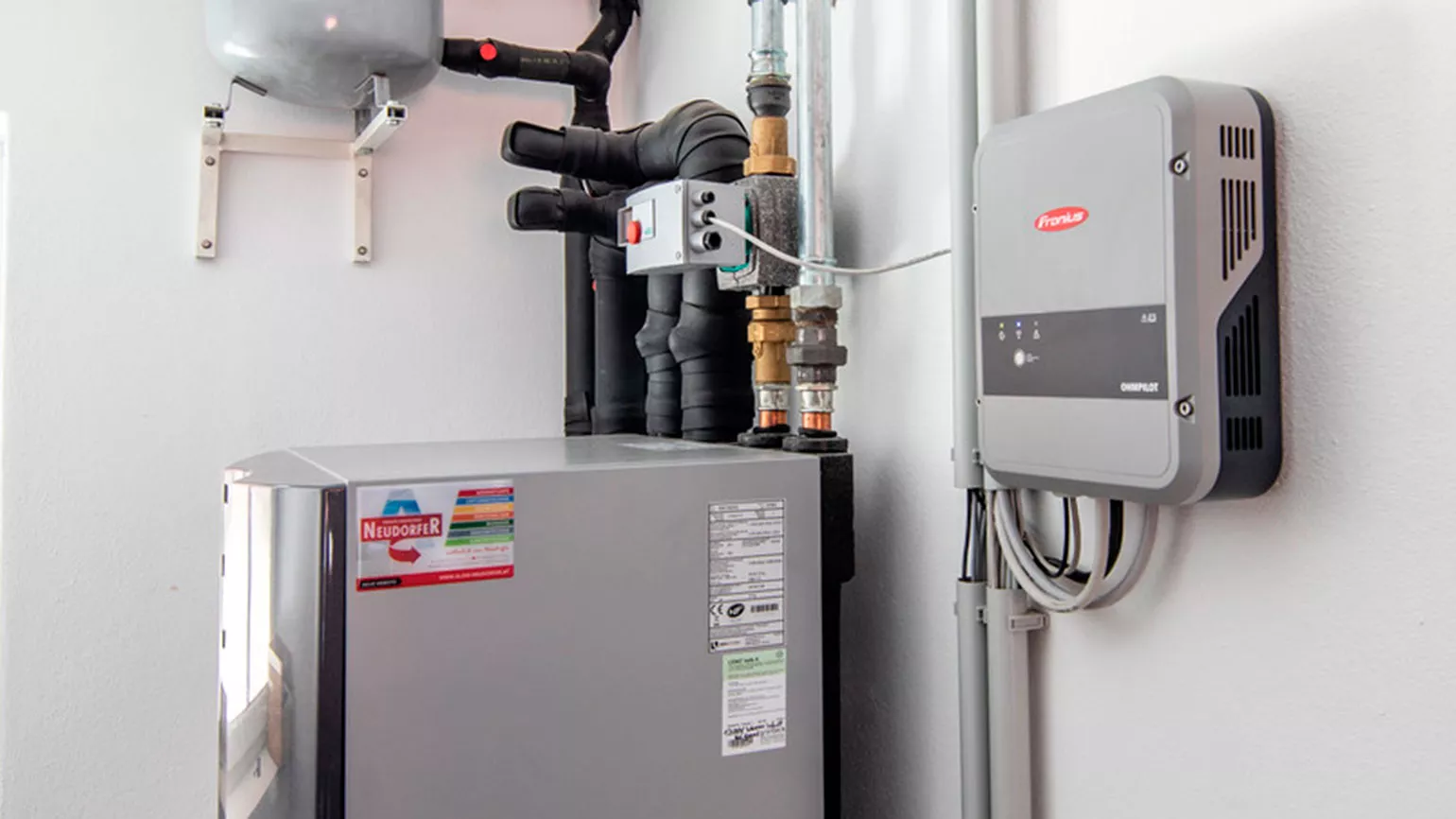

The Fronius Ohmpilot is the first choice for PV system owners who want to use their solar power to heat water. Thanks to the consumption regulator, the solar power can be used even more efficiently for heating hot water. Surplus solar energy which is otherwise fed into the public grid, goes, via the Fronius Ohmpilot, directly to loads such as a heating element, towel radiator or infrared heating. Even small surpluses are consumed with the heating element in a continuously variable manner and not fed into the grid.
The PV energy is thus used in the best possible way in the household and the self-consumption rate can be increased to up to 100 percent. This not only affects the return on investment of the PV system, but also the energy costs. In the summer months, the hot water consumption can be almost entirely covered by solar energy.ä The primary heating source usually remains completely switched off, which also increases the service life of the heating system.

The Fronius Ohmpilot is a consumption regulator that uses the surplus energy from the PV system to heat water in the boiler. This means the water is heated with solar energy instead of conventional heating sources, such as an oil or pellet heating system. One of the key advantages of this solution is the continuously adjustable regulation from 0 to 9 kW, which enables the PV electricity to be used particularly efficiently. The Fronius Ohmpilot can also control other ohmic loads such as a towel radiator or infrared heating.

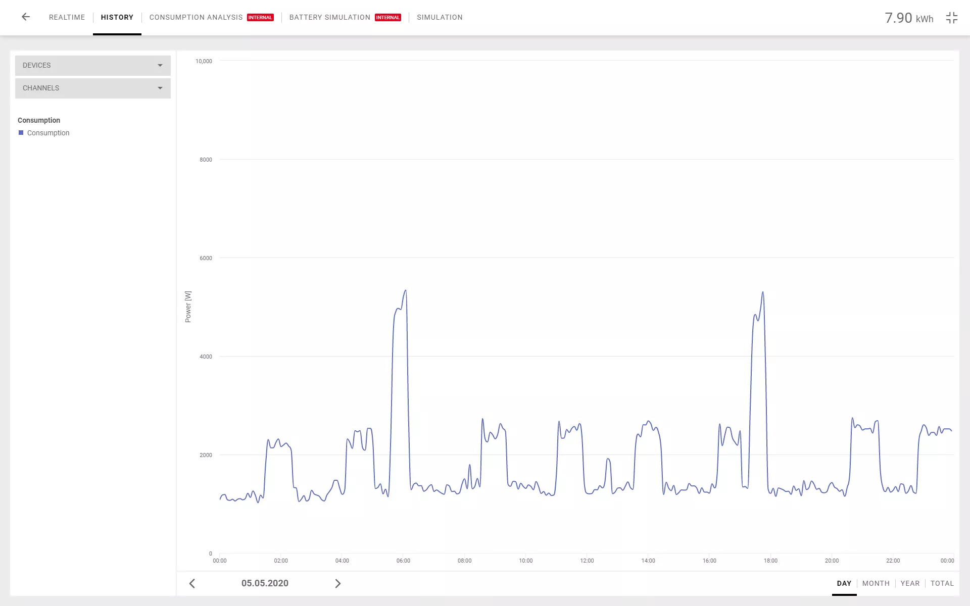

The load profile for a household with a heat pump clearly shows how often the heat pump turns on and off during the course of a day.
The Ohmpilot combined with a buffer storage tank comes into play here. This fast consumption regulator uses the surplus PV energy exactly to the watt and heats the hot water in the buffer storage tank via a heating element, for example. This means that the heat pump does not have to be active as often and therefore has a longer service life.
