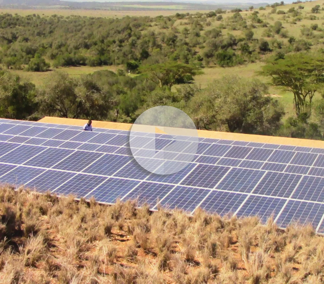

The installation consists of seven systems, the PV capacity is 312 kWp. If the company were to generate the equivalent amount of electricity using diesel generators, the annual cost would be $260,000 – a figure that does not include the costs of transporting the fuel, intensive maintenance of the generators and service costs.
In just four years, the fish farm has saved over one million dollars thanks to the photovoltaic MicroGrid.

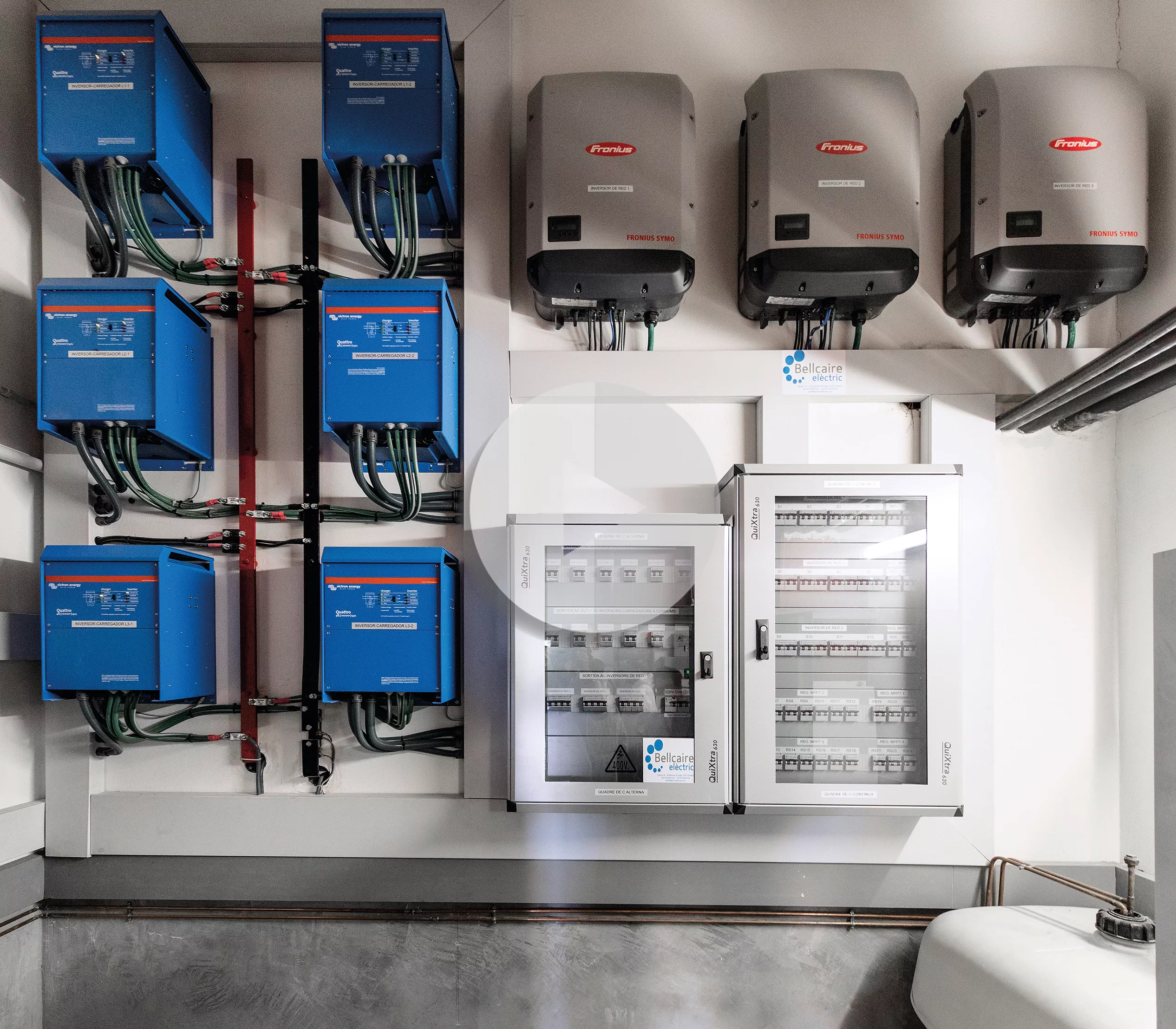

The installation owners were just as demanding when it came to the quality of the system components. The combination of inverters from Fronius and inverters/chargers from Victron promises perfect compatibility, including for monitoring purposes.
As usual, yields from the PV system can be checked via the Fronius Solar.web online platform. However, this data can also be sent to the Victron Portal.

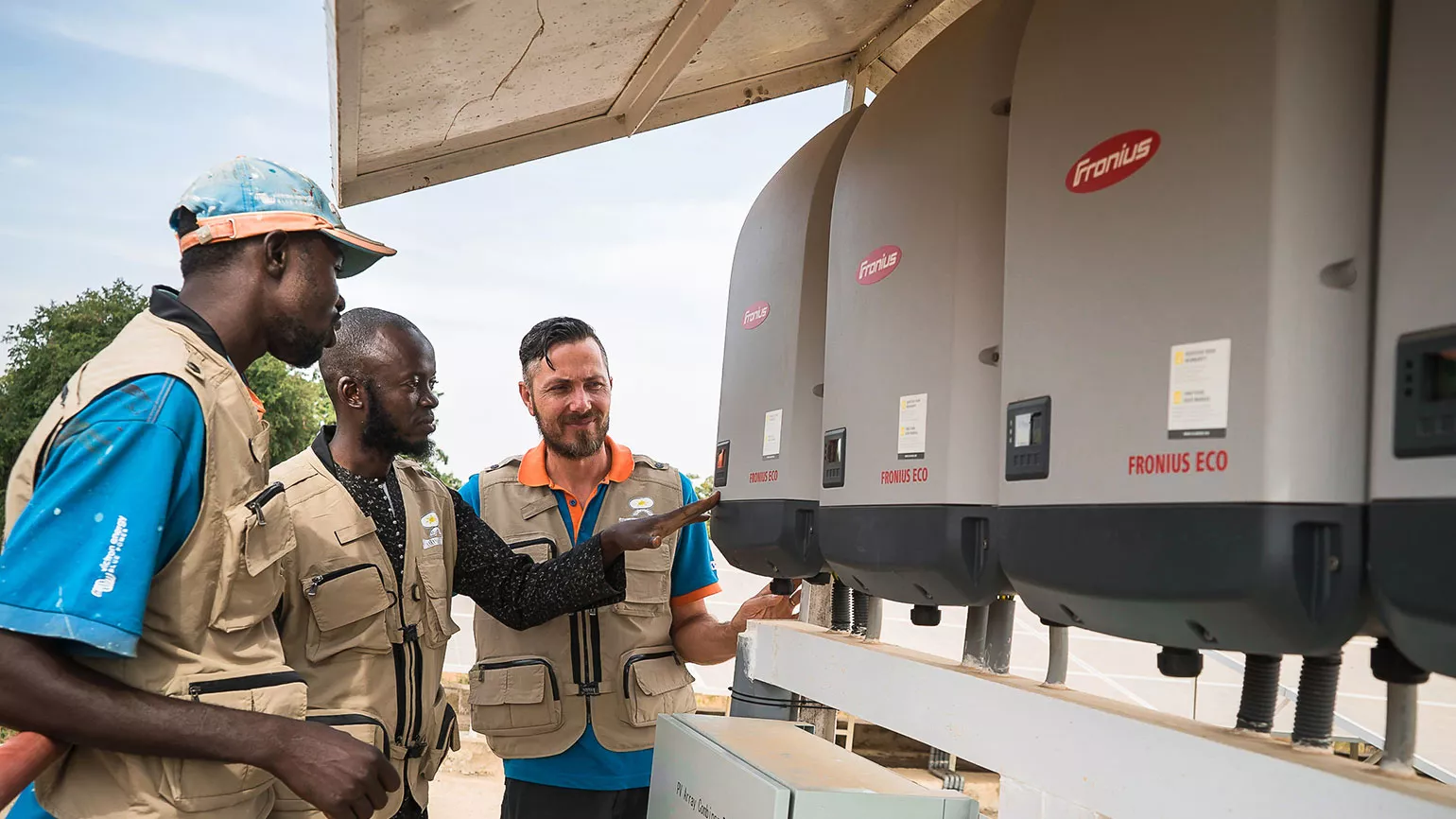

Easy installation with local installers
Fronius inverters are known for how easy they are to install, with the Fronius Eco inverters being commissioned by local installers. Should servicing or maintenance be necessary, the local installers can repair the device without delay thanks to the PC board replacement technology. With Fronius inverters, you do not need to replace the entire device, but only one PC board. This saves on ongoing operating costs, as a single service technician only needs to be called out once to perform the necessary work.

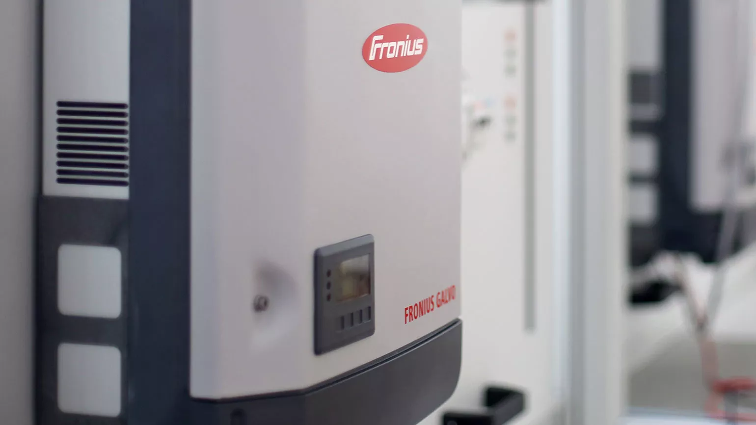

Active cooling increases service life
The Fronius inverters were installed at the fish farm in an outdoor location. With an IP 65 protection class, this is no problem. Yet the real showstopper is the active cooling technology, which means the inverters can produce maximum yields even at high outside temperatures, as the derating process is not activated until much later.
Furthermore, active cooling extends the service life of the inverter by keeping the temperature of the power electronics constantly low. Unlike inverters with passive cooling technology, Fronius devices do not have to be regularly serviced. This has a positive effect on the long-term operating costs and results in the PV system paying back its installation costs more quickly.

System components:
  • Size PV installation: 312 kWp
  • 12 x Fronius Eco 27.0
  • 1 x 115 kVA Victron Quattro Inverter/Chargers

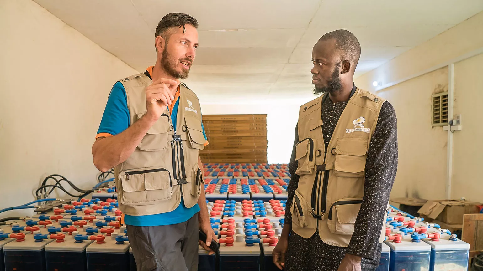

  • 120x 2 V/3000 AH OpzS Batteries
  • Color Control GX
  • 2 x MPPT SmartSolar 250/70
  • 6 x BYD Battery Box 10 kW
