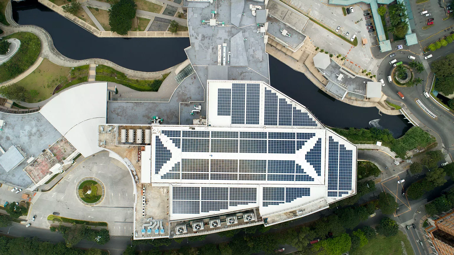

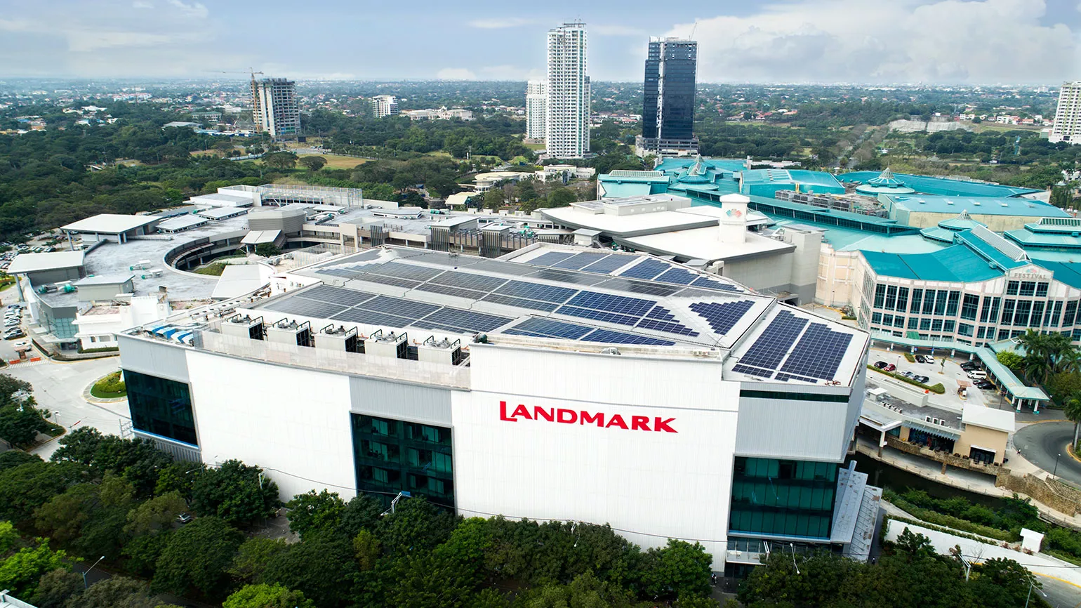

If the solar modules in a PV system are oriented in different directions, this makes the design of the system more complex. The system on the roof of a large supermarket in the Philippines is configured in five different blocks. The customer was won over by the absolute flexibility of the Fronius Symo with SuperFlex Design integrated as standard.

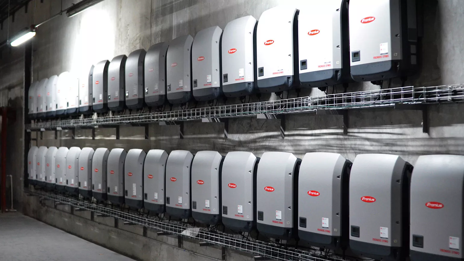

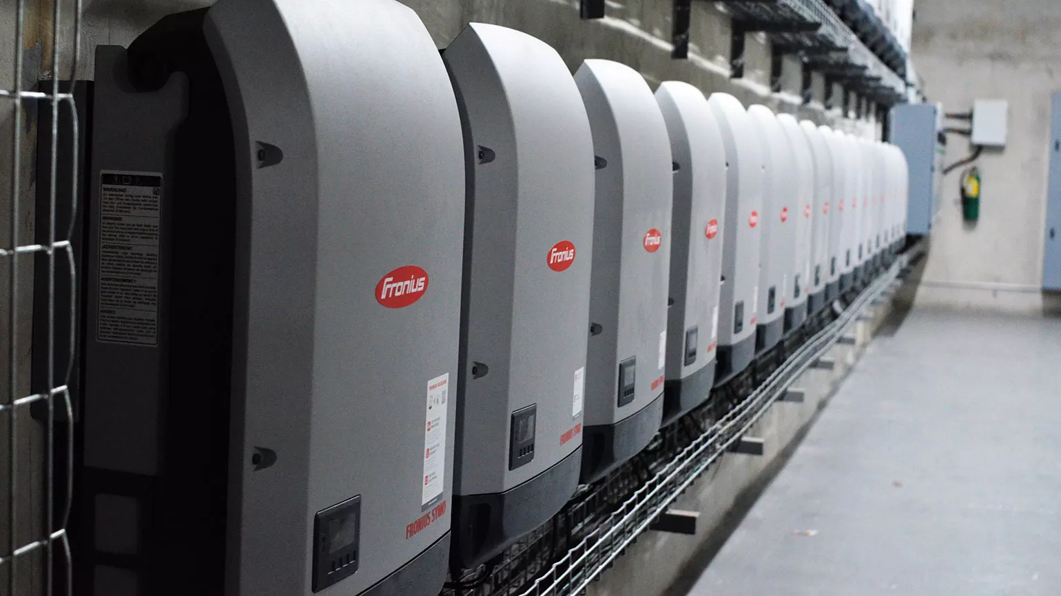

The 740 KWp PV system on the roof of the Landmark Corporation was commissioned only very recently. The system will produce most of the daily power requirement of the department store. The system operator wanted to be able to use their own system to control consumption in the buildings, which meant only devices with open interfaces could be considered when choosing the inverter. The Fronius Symo is one of the few inverters on the market to have this facility. Moreover, it is also possible to use the Fronius system in parallel with the external control system.

  • The complex configuration of the roof meant flexibility in the design was a must
  • Fronius and third party components to be used in parallel for system control and monitoring

  • The Fronius SuperFlex Design allows all systems to be reliably dimensioned
  • The Fronius Datamanager has numerous open interfaces for third-party components

  • The daily power requirement is largely covered by the PV system
