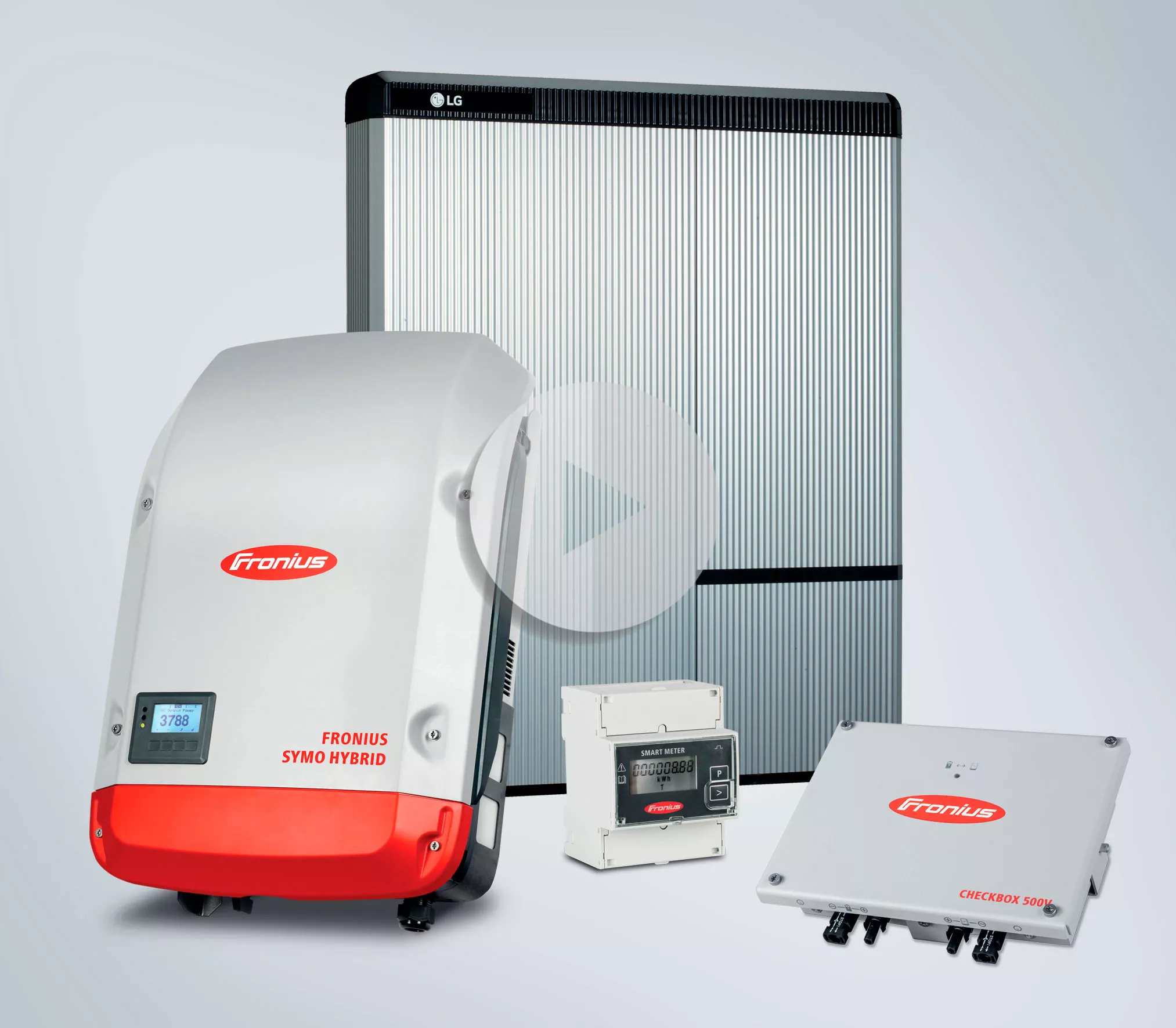

Fronius Symo Hybrid with LG Chem Resu
The LG Chem RESU is a high voltage battery space-saving battery system. The reduced wight of the LG Chem Resu allowes to install the battery on the wall.
Please note:
  • Fronius GEN24 Plus Series is not compatible with the LG Chem Resu 7H/10H (Type-R)
  • Fronius Symo Hybrid is compatible with LG Chem Resu 7H/10H (Type-R)
  • Fronius Check Box must be installed
  • Backup power is not available with LG Chem
