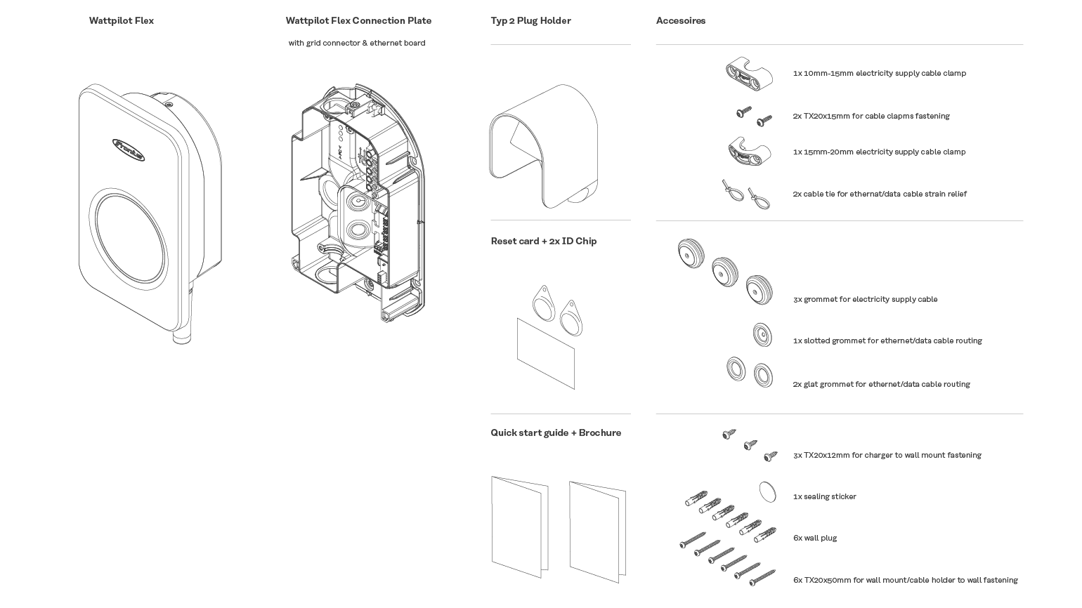

Wattpilot Flex: Wattpilot Flex, mounting bracket and Type 2 plug holder including screws and dowels, reset card, 2 ID chips, quick guide, strain relief 10 - 15mm and 15-20mm including screws, 2 cable ties, 6 rubber grommets. Optionally, ID chips (10 pieces) and a stand can also be purchased.
Wattpilot Home / Go: Mounting bracket, including screws and dowels, Wattpilot, theft protection, reset card, ID chip, and quick guide. Optionally, a Type 2 cable (5m), ID chips (10 pieces), an additional mounting bracket, and various adapter sets can be purchased.
