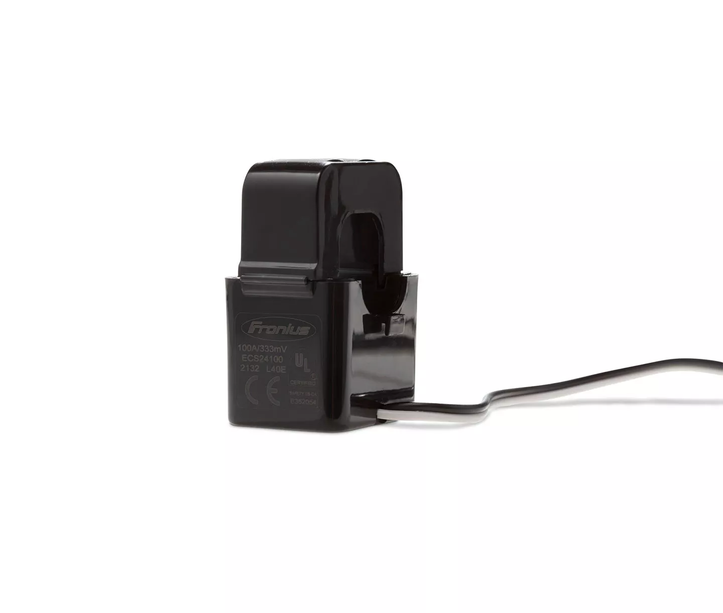

Only to be used with current transformers with 333 mV secondary output.

Current transformersPrimary: 1 - 5000 A / secondary: use only CTs with voltage output 333 mV
