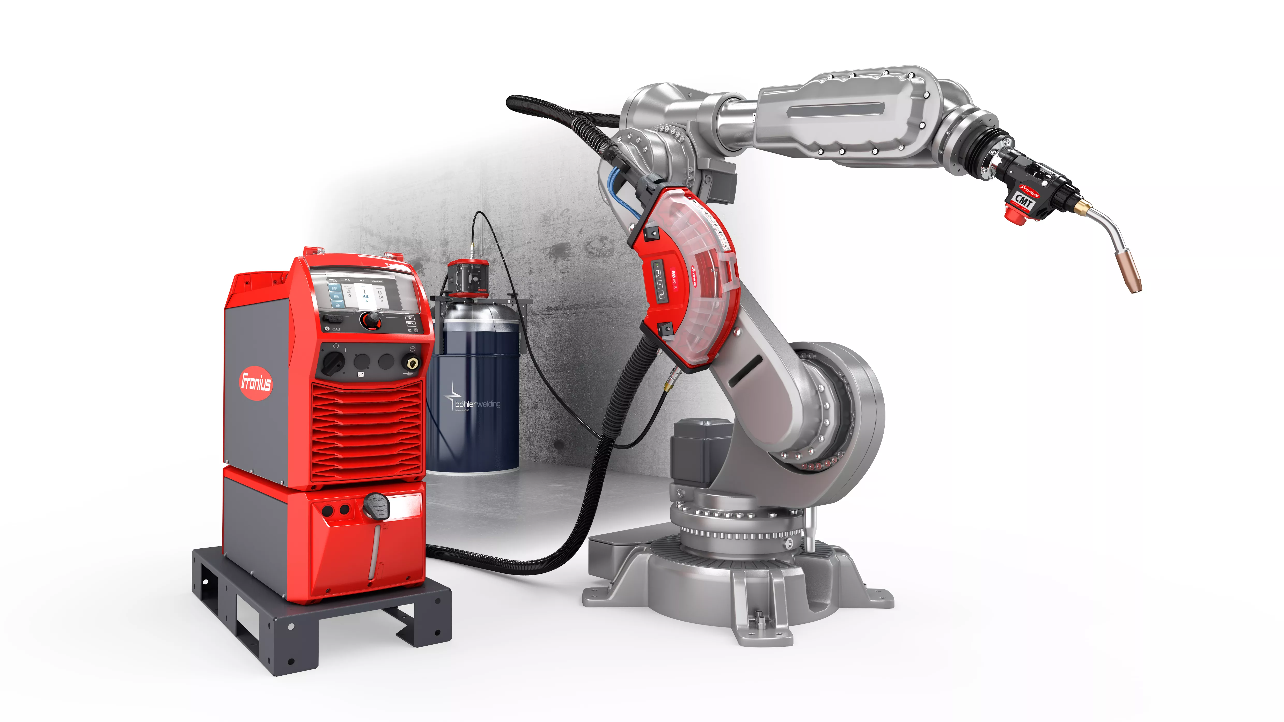

WireSense is the assistance system from Fronius which makes robotic welding more efficient. The wire electrode is turned into a sensor that checks the component position before each weld. Manufacturing inaccuracies can be compensated for and perfect welding results achieved by reliably detecting actual sheet edge heights and positions. Rework and component rejects are largely eliminated, while additional optical measuring devices become unnecessary, resulting in significant time and cost savings.
Component deviations such as varying air gaps or clamping tolerances can cause welding problems. In the worst case scenario, these deviations result in a change in the welding position and cause a lack of fusion in the weld seam. For this reason, many manufacturing companies use optical measuring devices for robotic welding. Not only are they expensive but they also significantly restrict component accessibility, need regular cleaning and require additional calibration between the Tool Center Point (TCP) and the sensor. WireSense from Fronius offers an easier, more robust and precise alternative.

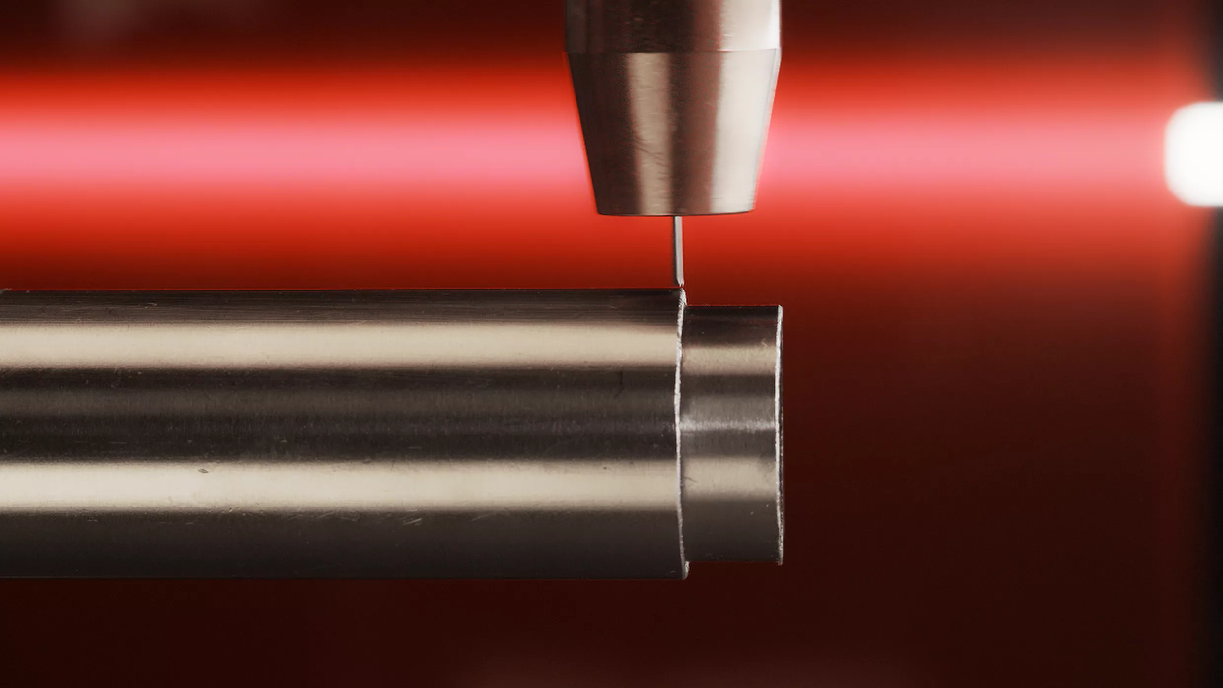

The science behind WireSense
WireSense technology does not require any additional sensor hardware components – instead the wire electrode is used as a sensor. The welding torch scans the component with a reversing wire movement and the welding system sends the height information and the edge position to the robot. For example, if a lap joint is being welded, the edge position can be precisely defined, and the system can react to any deviations. The robot adjusts the weld seam process based on an application-specific program.
By evaluating the height information, the robot can determine both the course of the edge and the actual edge height. It is also possible to determine the exact air gap between the sheets. Edges are detected from a height of 0.5 millimeters. WireSense can be used with steel, stainless steel, aluminum, and other alloys. It is with aluminum that WireSense truly comes into its own, as reflective surfaces are frequently a major obstacle for optical measuring devices.
Furthermore, optical sensors are usually installed on the robot as additional hardware where they become disruptive contours the robot arm. Depending on component accessibility, this makes the use of cameras or lasers problematic. The wire sensor does not impose any such restrictions.

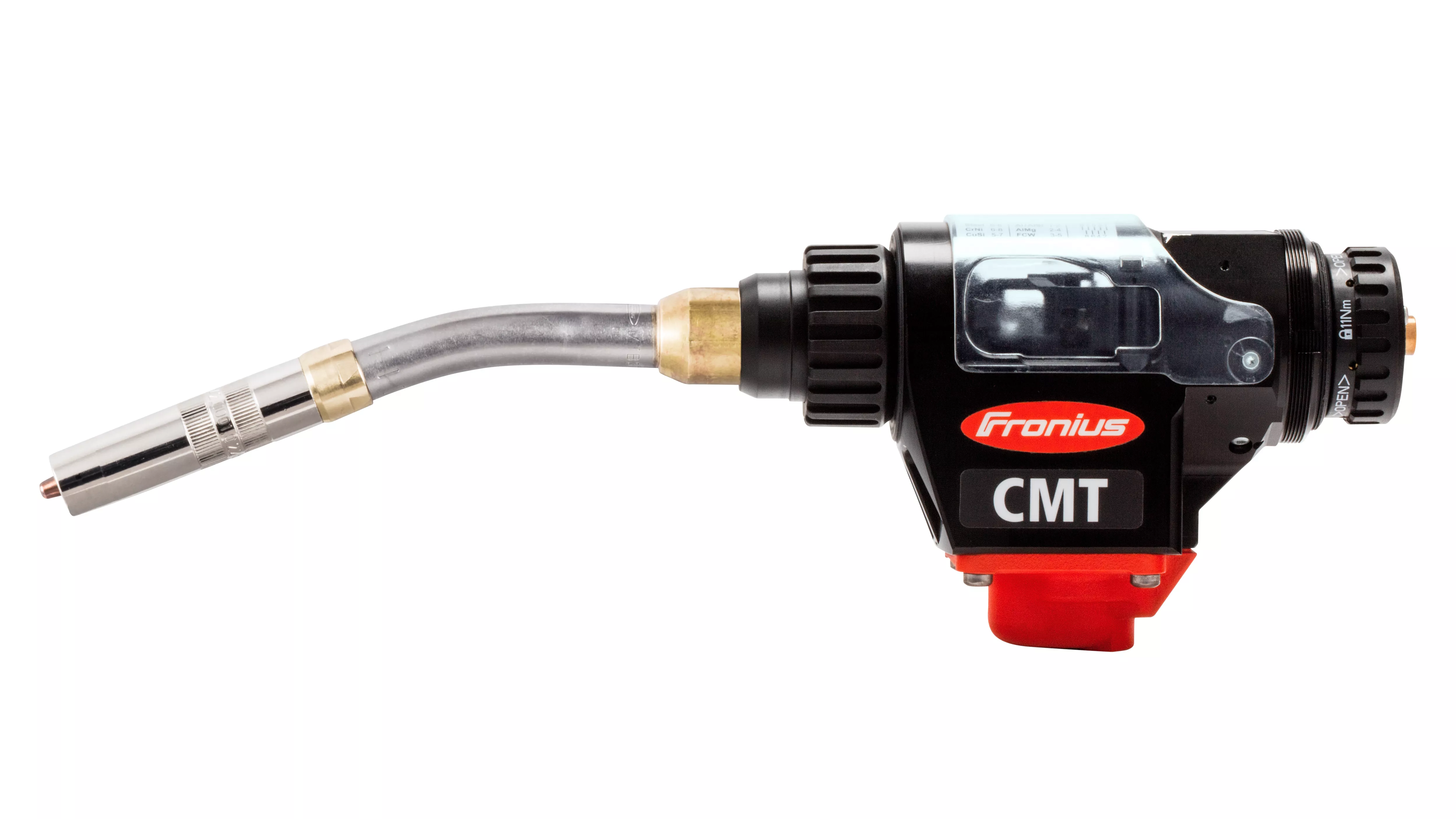

WireSense can be used with any TPS/i welding system from Fronius that is configured for the use of the CMT welding process. The precise wire movement of the Robacta Drive CMT wirefeeder, which sits directly on the torch body, is crucially important. Retrofitting of existing welding systems is possible at any time due to their flexibility.
