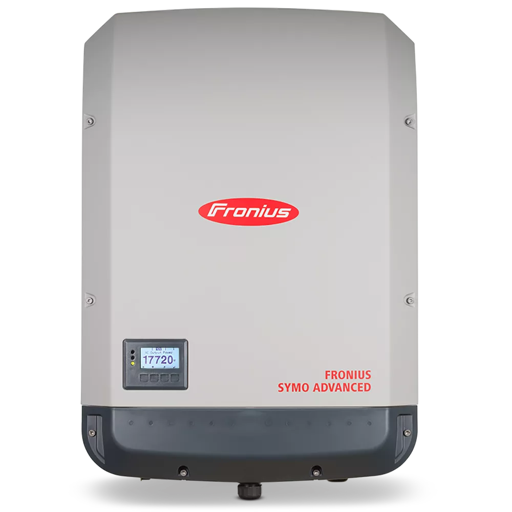

Fronius Symo Advanced
Designed to rely on.
Further developed with safety in mind: the Fronius Symo Advanced opens the next chapter in the Fronius SnapINverter portfolio. The inverter combines proven performance with new safety technology, making the Fronius Symo Advanced the future-proof choice for commercial photovoltaic systems of all sizes. The latest generation of the inverter with power categories ranging from 10 to 20 kW impresses with reliable arc protection through the new Fronius Arc Guard technology, SuperFlex Design for absolute freedom in roof planning and maximum yields through the Dynamic Peak Manager.
