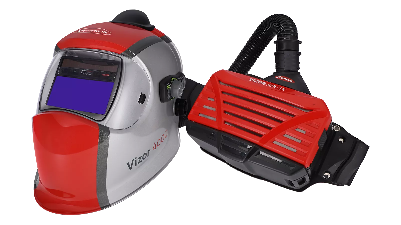

Vizor Air/3X
AUTOMATIC EYE PROTECTION WITH FAN FILTER DEVICE
Vizor Air/3X is a protection system for the eyes and airways that makes no compromises in occupational health and safety or comfort. In addition to proven glare protection technology, a unique air flow system within the welding helmet offers infinitely variable air distribution between the forehead and breathing zones. Vizor Air/3X is therefore a truly “clean” solution for the user, as 99.8% of particles are filtered out and pleasant cooling is provided for the welder.
The lithium-ion battery delivers an operating time of up to 18 hours. An acoustic and visual alarm is triggered if the battery is low, the filter is clogged or missing, or in the event of low air flow.
The system is used where the environmental conditions do not allow for optimum extraction of the welding fumes, for example for flexible welding work, or work in confined spaces and highly polluted ambient air.

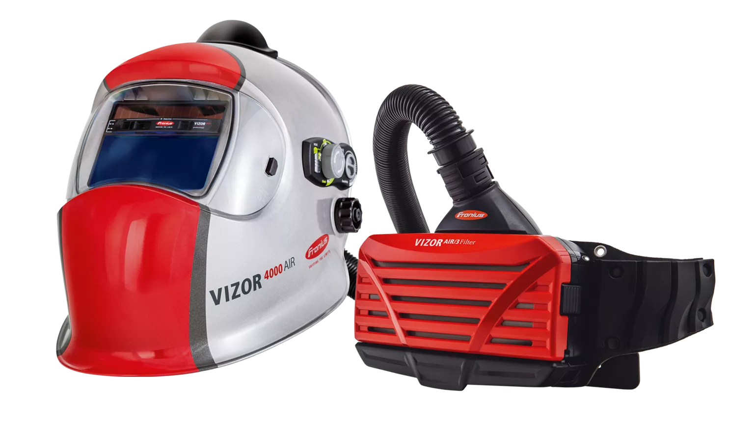

The Vizor 4000 Air/3 Professional provides perfect protection for the professional welder and makes all welding tasks even safer, more efficient, more precise and more comfortable. One special feature on this model is the option of selecting from automatic and manual operating modes. The unique air-flow guiding system inside the mask offers a continuously adjustable air circulation between the forehead and breathing zone. This lets welders work in a clean environment even when the ambient air at the workplace has up to 20 times the maximum permissible particulate concentration. The fresh-air supply is certified to EN 12941:1998 TH3P.
Product details
Shade level range4/5-9 u, 4/9-13 (man,) bzw, 4/5-13 (auto)
Maximum air flow / fresh-air supplyLevel 1: min, 170 nl/min Level 2: min, 210 nl/min Level 3: min, 240 nl/min
Switchover time / darken0,17 ms
Switching time dark / light0,1s-2,0 s
Cartridge size [LxBxH]90x110mm
