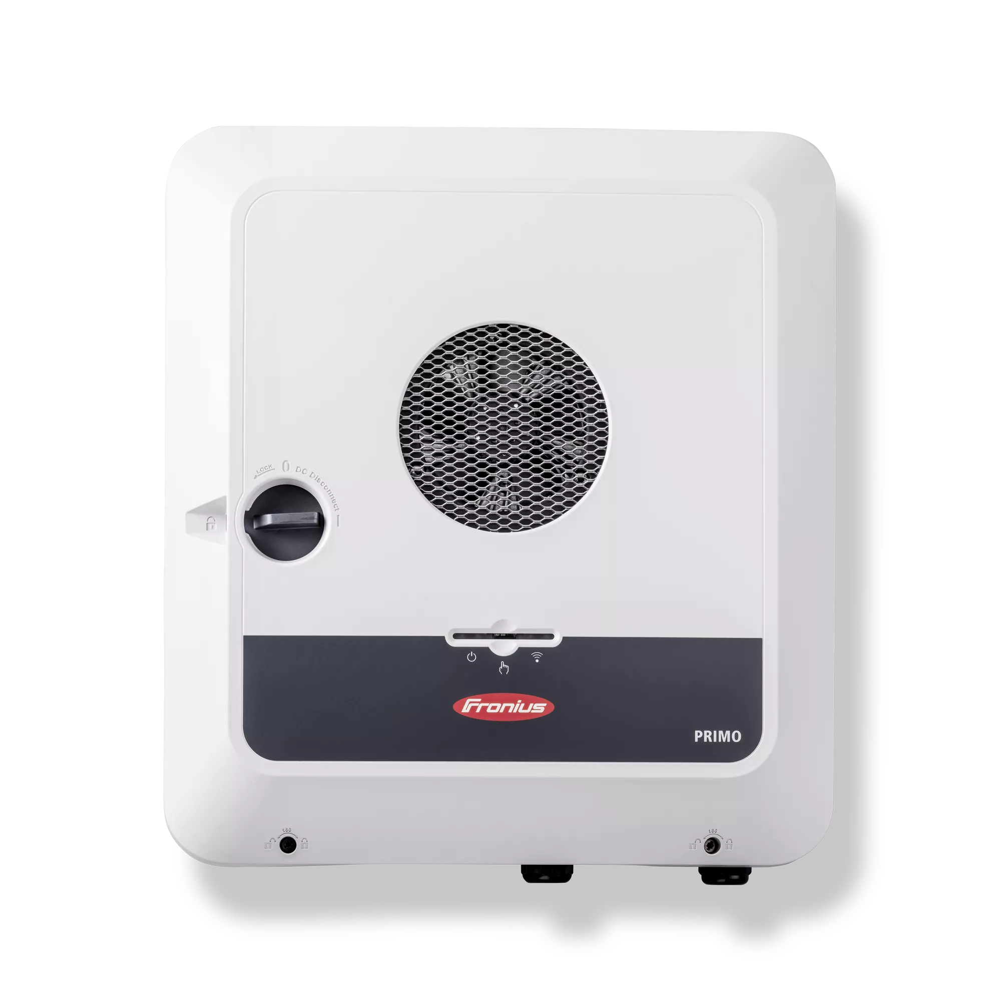

Fronius Primo GEN24 Plus
Inverter for private PV systems with PV Point or Full Backup
Our single-phase Fronius GEN24 Plus hybrid inverter is the ideal core for private PV systems. The Fronius GEN24 Plus offers an integrated basic backup power supply with PV Point and even a full backup power solution through the option of connecting a battery storage system.
The Fronius GEN24 Plus hybrid inverter enables energy self-sufficiency for electricity, heating, cooling and e-mobility with the use of a battery system. This means that the Fronius GEN24 Plus with Full Backup* has a backup power solutionthat even large consumers can use, such as heat pumps. What’s more, the Multi Flow Technology lets the hybrid inverter supply parallel energy flows in the system, even in backup power mode.

Width474 mm
Height530 mm
Depth165 mm
Weight15,38 kg
Weight incl. packaging19 kg
Degree of protectionIP66
Protection class1
Overvoltage category (DC / AC) 1)
2 / 3
Night-time consumption< 10 W
Inverter designTransformerless
CoolingRegulated air cooling
InstallationIndoor and outdoor installation
