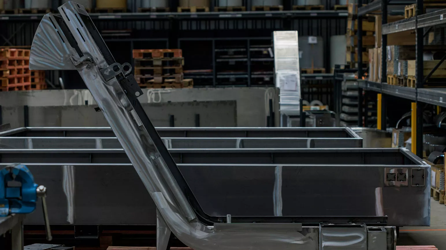

One of the biggest welding challenges at Knoll is processing thin sheets. The team needs to join components with material thicknesses from 1–6 mm with little heat input—while keeping warping to a minimum. Many of these components are visible parts, so the seams have to be perfect from a metallurgical perspective and look great at the same time. Given these requirements, the welding process has to be largely spatter-free with a low seam build-up.

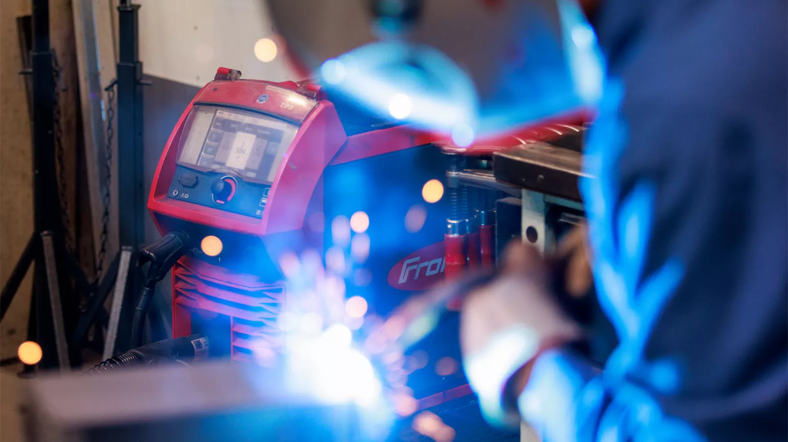

The welding specialists at Knoll use the TPS 320i welding machine in combination with the pulse welding process.  The intelligent MIG/MAG pulse synergic function offers a pulsed arc process with controlled material transfer. In the base current phase, the energy input is reduced to such an extent that the arc only just burns steadily and preheats the surface of the workpiece. In the pulsing current phase, an accurately controlled current pulse ensures targeted droplet detachment. Both phases result in precise, low-spatter welding across the entire power range.
