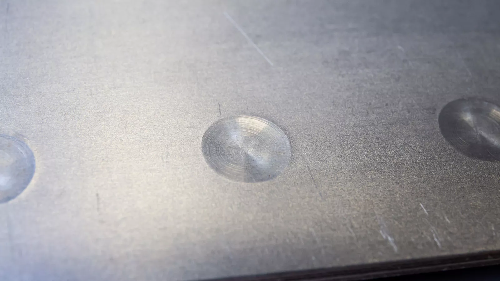

The entire housing is a safety-critical component, which means that the quality of the weld seams must be flawless. While the tray is welded using arc welding processes or lasers, resistance spot welding is used to attach the lid. The lid is usually made by joining three plates: a thin plate forms the basis of the lid and two thick plates are used to reinforce it. In order to ensure that it is completely sealed, the lid is joined using a large number of welding spots. As the quality of the component is vital, each spot must be absolutely perfect. The DeltaSpot spot welding system with a continuous process tape is ideally suited to this process. Unlike conventional spot welding, the lid can be welded without the need to dress the electrode tips, which significantly increases productivity. The additional, regulated heat input of the process tape also allows for precise control over where the welding spot is formed. This means that all three plates, including the thin plate, are sufficiently bonded.
