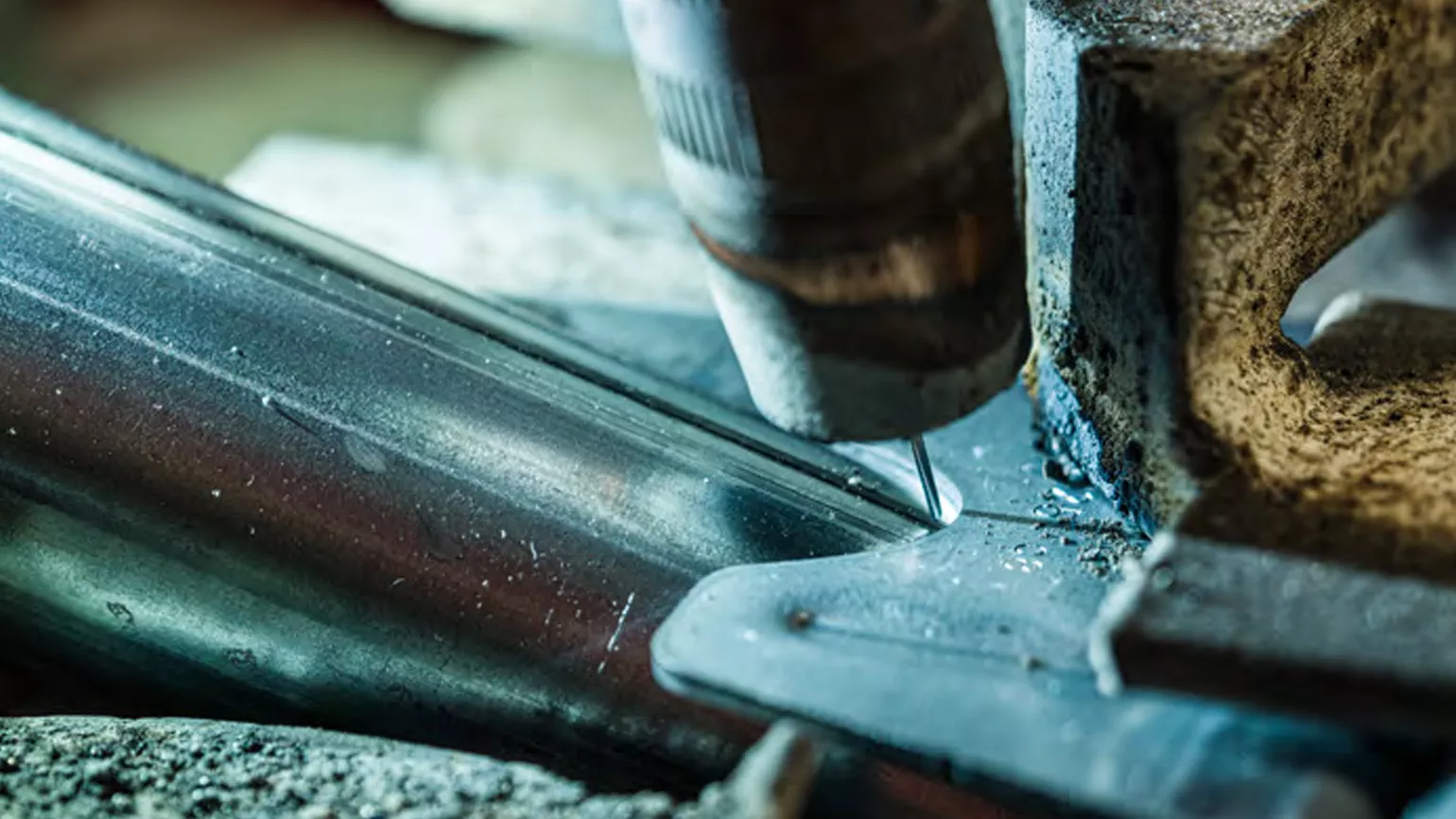

The Fronius application technology team sprang into action: “Our contact partner knew that it was already possible for the wire electrode to be ʽrepurposed’ as a sensor on the intelligent TPS/i power source. For example, the Fronius R&D department had already conducted successful trials in the past. Furthermore, our power sources are configured for the CMT process and so all pre requisites for a ʽfield test’ were already in place,” adds Miersch on the constructive and solution-orientated cooperation.

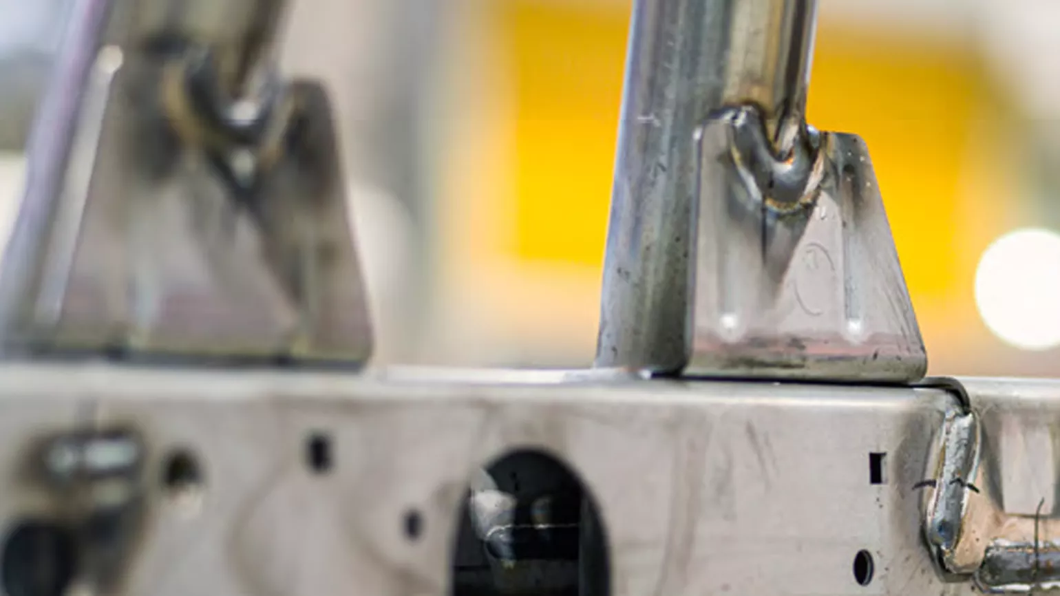

“Since installing WireSense, the robot is able to find the sheet edge reliably and is able to adjust the welding path accurately to the relevant conditions,” says a delighted Schober. “We now have excellent and consistent penetration stability and are consistently able to achieve the perfect join between the upper and lower sheets,” underlines Miersch. Until now, Magna has only used the WireSense on one individual component in the aforementioned 2018 production line, which was the “cross bar ROPS” (roll-over protection structure): “This is where we had the most leeway and so it made sense to implement the process for testing here. Furthermore, the WireSense needs more time for the scanning process before welding. Since a buffer is factored in for this component, delays in cycle times have no effect on overall production.”
