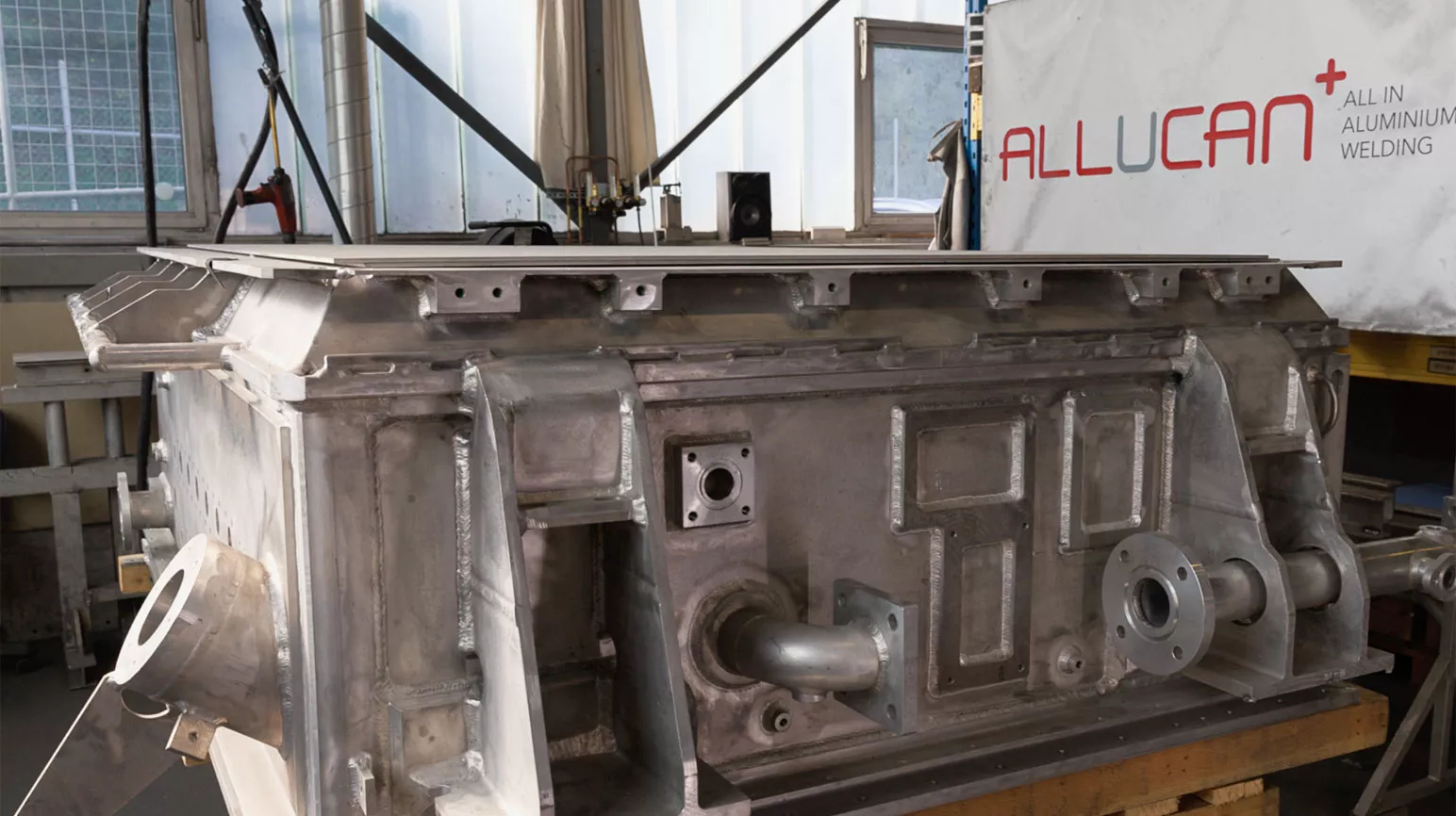

Transformer enclosures and special housings for electric locomotives
ALLUCAN AG manufactures lightweight transformer enclosures and special housings from aluminum, which are primarily used in high-performance locomotives and high-speed trains. Such aluminum housings increase the energy efficiency of locomotives, while also complying with strict safety requirements. This demands precisely placed welds with consistent geometries and layer build-ups. Up to 20 or more weld layers have to be produced, depending on the material thickness.
Welding often takes place using the TIG welding process, which brings several advantages. For example, TIG enables the welder to produce flawless, flat welds, which guarantee an optimum basis for the subsequent layer build-up, while the smooth TIG beads minimize the risk of notch effects, which enhances the structural integrity of the welded joints.
MIG welding—which is particularly suitable for thicker materials—is used to build up the layers. It allows high welding speeds and offers good control over the weld. This is where the iWave AC/DC Pro 500i multiprocess welding machine excels, guaranteeing welding quality without compromise for every single weld. One particular advantage of this welding machine is the rapid and straightforward changeover from TIG to MIG and vice versa.
