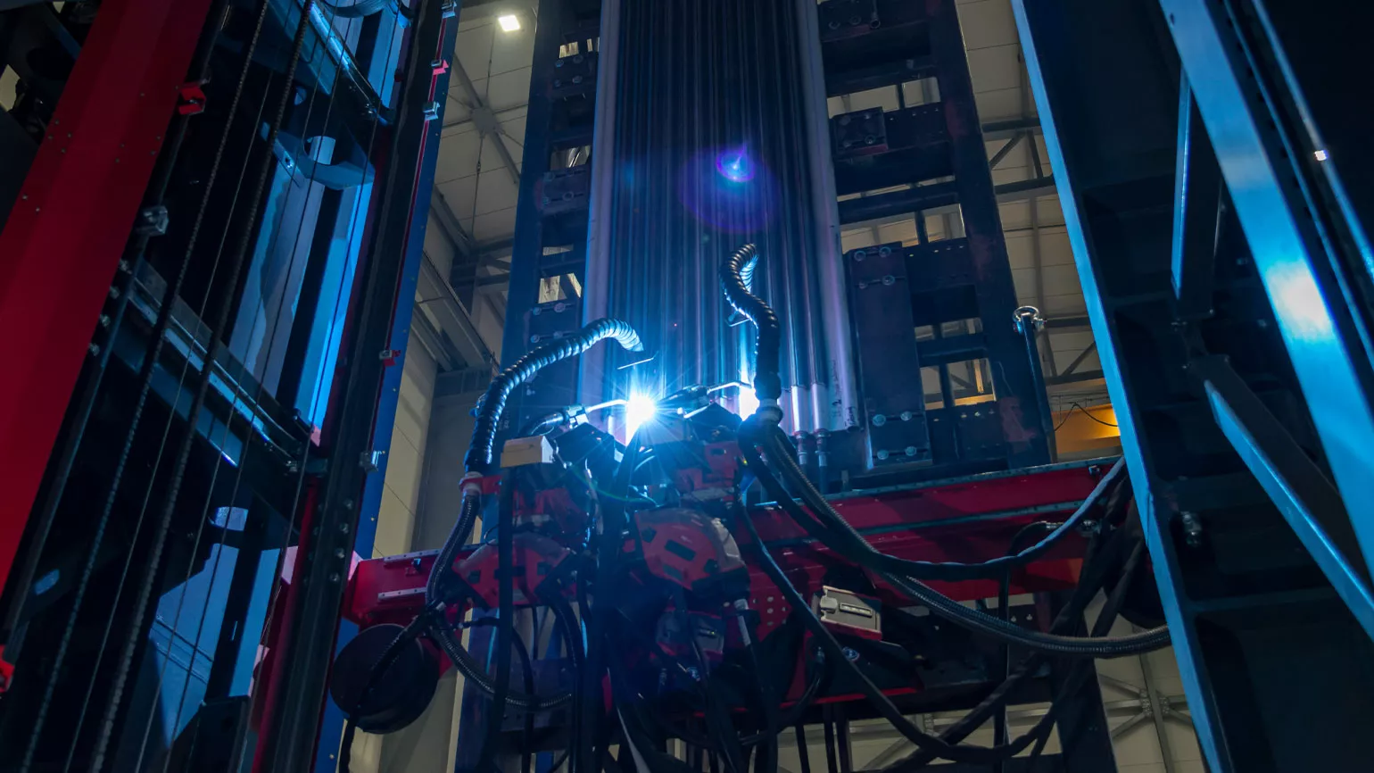

CMT-Cladding-Tower
The large water-tube boilers used in commercial and industrial power generation use heating surfaces called finned walls made from tubes and flat iron. Due to the changing trends in fuels and the burning of increasingly difficult and aggressive fuels, it is necessary to develop additional anti-corrosion protection for the finned walls. Hardfacing is the most efficient way to protect the finned wall surfaces.
“To surface the finned tubes, we use a cladding tower from Fronius Welding Automation that is approximately 15 meters high,” explains Arkadiusz Osuch, managing director of FAKOP. “It can accommodate two 12-meter-high and 1.6-meter-wide finned walls and is operated by two elevator platforms, each equipped with innovative CMT welding technology.”

Welding is performed with horizontal oscillation from top to bottom in the vertical-down position (PG). Both elevator platforms are equipped with CMT welding technology and have intuitive HMI system controls with touchscreen, an ArcView camera and monitor, two CMT welding torches, and a joystick for fine adjustment.
Since welding torch temperature has a major influence on the dilution rate, all welding torches are water-cooled. To further ensure that the dilution limit of 3% is never exceeded, precise regulation by the plant’s cooling system is required.
One system optimization worth mentioning is the new fine adjustment joystick for the welding torch position. Originally it was necessary to manually move the torch into position using a slide rail. This made fine adjustment almost impossible and always required extreme dexterity. With the ArcView camera and joystick, fine adjustment can now be carried out quickly, easily, and with millimeter precision.
User safety is ensured by fume extractors on each welding torch and a dark-red tinted protective curtain that seals off both elevator platforms, and extends the full height of the system protecting welding operators from UV radiation.
