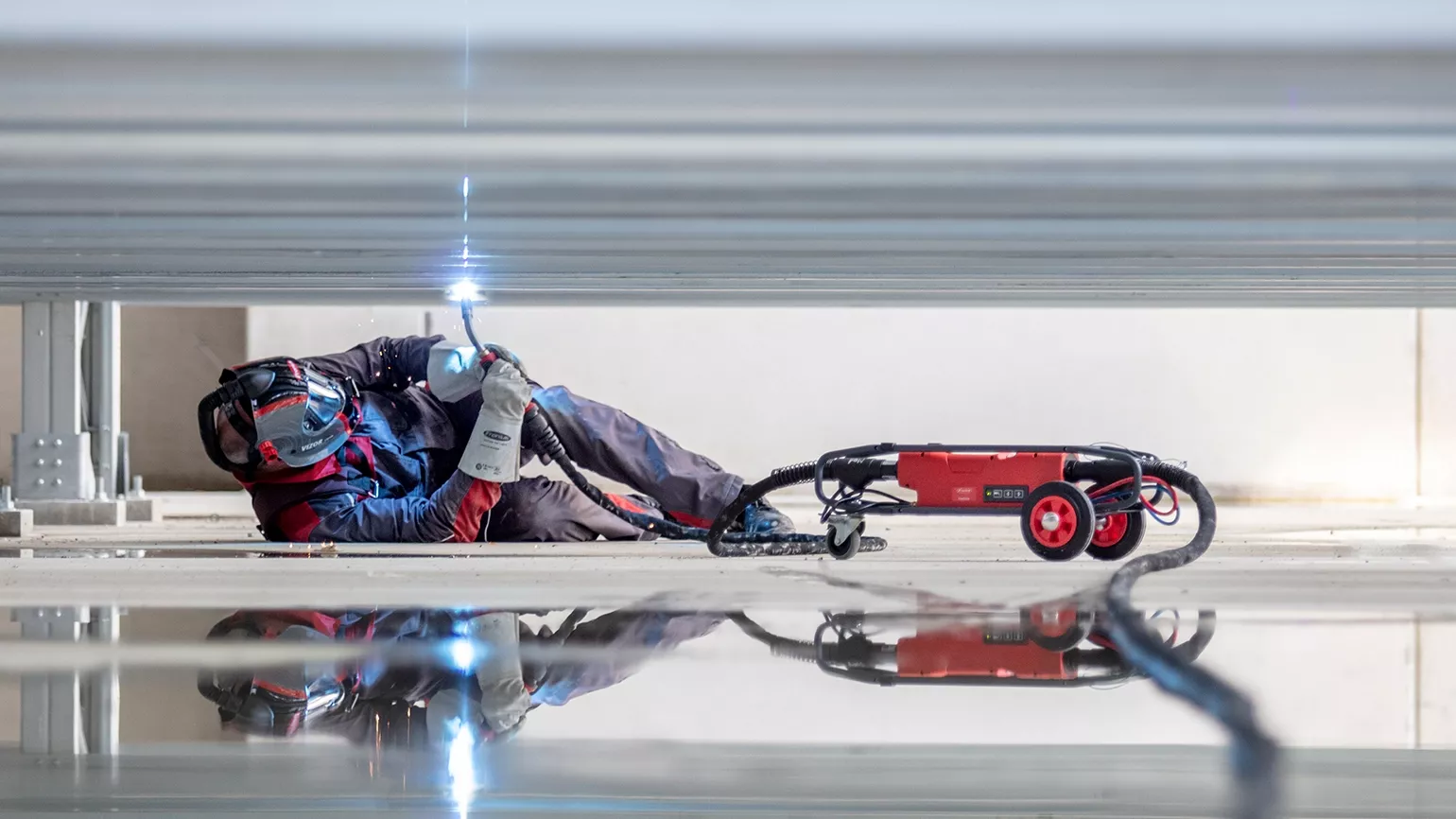

Extends your radius of action
Do you need to bridge larger distances between the welding system and weld location easily and without fuss? Not a problem with the FlexDrive WF 25i – a small and portable intermediate drive between the wirefeeder and welding torch.
The FlexDrive demonstrates its strengths most impressively in situations where it is difficult to get the welding system and wirefeeder right to where they are needed, such as on shipyards or in the construction of bridges, tanks and containers, and rolling stock.
Your advantages
  • Extended radius of action: up to 25 m distance between main wirefeeder and welding point
  • Flexible and compact: just 4.4 kg (excluding cage and wheels)
  • Compatible with all Push manual welding torches of the TPS/i generation (Standard, UpDown, or JobMaster version)
  • The cage, which is made of a tubular construction, allows the FlexDrive to be suspended or hung in the most suitable position
  • The synchronized motors of the FlexDrive and the main wirefeeder guarantee an optimal wirefeed

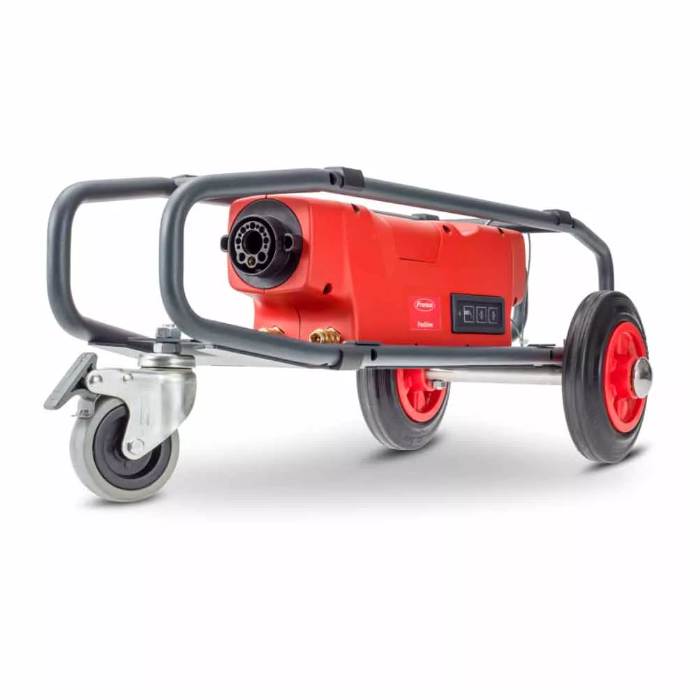

WF 25i FlexDrive
Option: Cage with wheels
1
FSC connector for welding torch push (no PullMIG)
FSC connector
2
Swivel castor with brake
3
Water connectors
4
Userinterface 2
- Operating status LED
- Gas test button
- Wire feeding button
- Wire retract button
Userinterface
5
Impeller diameter 160 mm
6
FSC connector for the extension hose pack
FSC connector
7
Jobmaster Userinterface (JM variant)
8
Clamping shell sliders
9
1
2
FSC connector
3
4
Water connectors
5
Userinterface 2
- Gas test button
Userinterface
6
7
FSC connector
8
9
