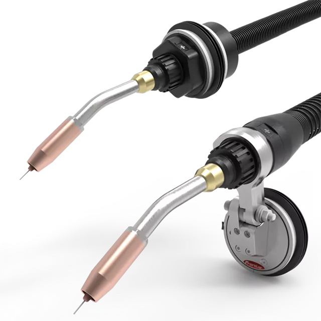

Robot torch systems at a glance With robotic welding applications, it’s usually the material, the length of the hosepack, and the welding process that determine which torch system to use. We differentiate between a Push system and a Push/Pull system, which involves attaching a second wirefeeder directly to the torch body. This provides a stable welding process, even in the case of long wirefeed distances, soft filler metals, or special applications, such as CMT.
Robot torch body The robot torch body is supplied in two different lengths and four different angles. Special geometries improve component accessibility.

Wirefeeder Robacta Drive/Robacta Drive CMT The Robacta Drive/Robacta Drive CMT wirefeeder impresses owing to its compact design, which improves component accessibility, and its light weight, which enables it to be used on robots with high traversing speeds.
