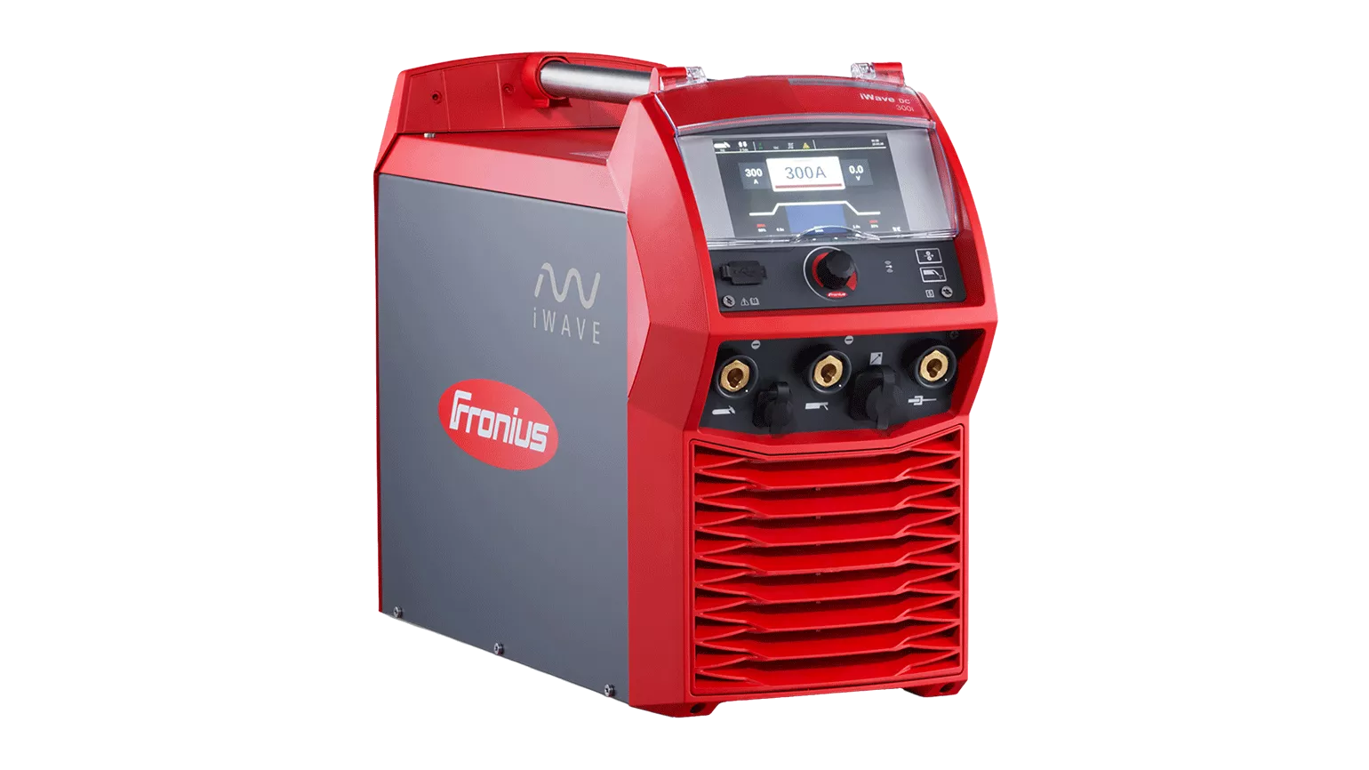

iWave TIG
Product details
GENERAL DATA
Mains voltage3 x 400 V
Mains voltage tolerance+/-15 %
Welding current min.3 A
Welding current max.300 A
Welding current / Duty cycle [10min/40°C]300A / 40%
Welding current / Duty cycle [10min/40°C]260A / 60%
Welding current / Duty cycle [10min/40°C]240A / 100%
Operating voltage min.10,1 V
Open-circuit voltage96 V
Degree of protectionIP23
Length
706 mm
Width
300 mm
Height
510 mm
Weight46,39 kg
Weight46,39 kg
Weight incl. packaging49,1 kg
Interference emission classA
